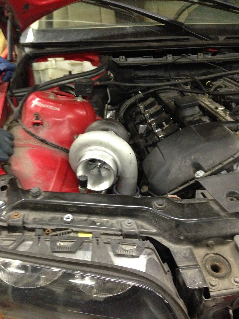

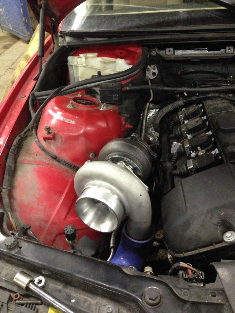

So here is cons and pros about CX racing kit
Cx racing kit is well designed but its obviously made by hand , and what i mean made by hand is that parts sometimes will not line up from a kit , I had intercooler piping not line up on hot side so i had to improvise to go around all the stuff thats there to keep A/C in stock location you would have to bend lines that come off compressor I gently used my 36mm wrench shuffed in a good spot to pry on and I did it. It worked perfect but not for long , on a hot summer day something exploads under my hood and I smelled the freon gas and I knew it was ac line that was next to the exhaust and I thought it had melted because it was 1/8 away from exhaust manifold , but that wasnt the case. Actually the clamp on the hot side that comes off the turbo to a 90 degree elbow that clamp tore the rubber line at least that was my verdict. So the conclusion of CX racing and keep A/C in same location is possible but not practical. Also my exhaust pipes wouldnt match , the downpipe is only 2.5 inch which is too small for my application ( you can easily make it 3 inch ) the downpipe off turbo to a center pipe never lined up , Center pipes turns under the car and my pipe had too wide of a bend and was at least 2 inches lower than lower point in the car which was bugging me a lot because it broke and was making a lot of noise and I caught few tickets for which I found myself in jail a year later. Anyways to conclude this I would only recommend buying intercooler kit and a manifold form CX racing kit they also got good turbo's which I use now it was 600 bucks for gtx3582r which got drained in oil because oil drain line kinked too much heat was coming off the manifold which made rubber loose its consistency and it collapsed on itself hence drenching turbo with oil to the point where I had a quart in the intercooler LOL , turbo has no shaft play and doesnt burn oil ))))
Now I took my ac out completely and im planning to run an electric unit in the "cancer" compartment of the engine bay , the reason why I took my a/c comp out is because i was getting tired of my oil drain line getting fcked up every so often, at the turbo there is that aluminum drain adapter that bolts up and the hose used to break( crack from heat ) and I would oil all over the place which caused fire , and then I just drilled a hole in the side of the block where compressor used to be I put a half inch brass fitting in there ( tapped it and all) Off the turbo I got that aluminum drain adapter that goes to 10an hose which I tapped on the inside and put a brass pipe around 10 inches long and connected it with a rubber hose Problem solved but no a/c now ? what the hell am i gonna do ?? So i looked up A/c compressor for hybrid cars and guess what toyota prius uses electric unit which has 3 wires and i assumed we got power ground and signal wire which isnt that had to make, but the question is if that comp is running on 12 volts ? also I just started loooking into it so I gotta find wiring diagram , Id have to buy ac comp with the lines that come off of it so i could weld them to the oem lines.

AIR FITLER FOR TOP MOUNT
This is where it gets tricky
My turbo has an inlet of 4 inches I ordered a mushroom filter and its fcking huge and will not fit under the hood nor in front of the turbo because turbo sitting very close to radiator support which sucks so implanning on cutting radiator support and weld extra metal on it so it doesnt become too weak because I need to cut a goot inch or so out of it.

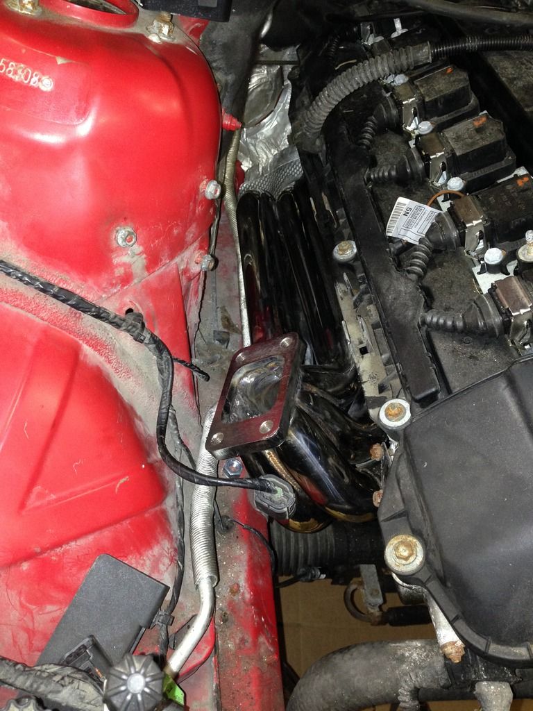

You do need a custom mount and you would still have to machine it ( as I had to do it because 63ar turbo would barely fit I still have it and its for sale . You go bottom mount if you only aiming for 370 hp thats all its good for and you will wind up with a too small of a turbo but midrange power and torque will be insane I had it for a year and it was fun but complicated to work on , with a top mount its a lot easier because everything is accessible .
And For bottom mount I wouldnt buy a kit I would make it myself using universal intercooler kit . In reality its a choice only in the exhuast manifold either top or bottom if you go bottom make sure you get cast iron manifold with a wastegate port on it ( I still have that manifold laying around because I never used it , the one i used was stainless tubes and they cracked EVERYWHERE because weight of the turbo was supported by the manifold which made it crack in places where you cant weld it on the car so u have to take it off and thats a pain. With CX racing mount I DONT EVEN KNOW HOW ITS STILL ALIVE AND NOT LEAKING OR CRACKED because I abused the sht out of it I had oil from valve cover leaking constantly on it , then I had a shot of freon at it and water and bad tuning where car would run really rich or lean and its still going strong.
Also cast iron manifolds are not perfect the one I got needs to be machined on the side of the flanged because its too thick and would bolt up to the head and its a very easy fix just grind it off a bit and done I guess it was made like that to have extra beef in it so the customer would have to machine it a bit for their liking I guess ( think positive)
Also oil drain is a problem with bottom mount turbo
Also running hotside piping will be hard but possible if you have welding traits ))) OR go like me and buy a diesel trucks coolant hose and slap it on
