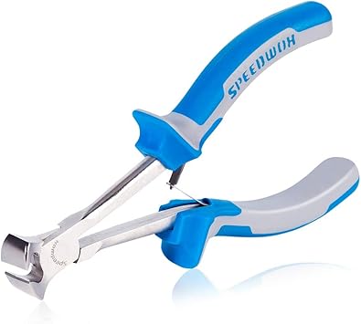

But for a proper tool, I think this $8 tool has the proper jaw profile:

Don't have all of my tools with me here so I used a pair of end cutting pliers similar to what Sapote posted to crimp my tie rod boots last week. They did the job. Three looked like I had the actual tool. One bowed up a little in the middle but I pushed it back flat with a flathead screwdriver.
