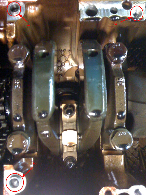

Has anyone tried the S54 oil pump in an M54B30?
I've been seeing oil pressures < 10 psi. I've seen 0 psi in turn 1 at VIR :eek:.
This is my second engine (original was M52TU), and I don't want to go through another one.
I have a baffle in the oil pan, but that does not seem to do much. It looked like going with the S54 oil pump would be the solution for my problem.
However the S54 oil pump won't bolt into the engine block.
Take a look at the picture below. If I line up the oil pump with the guiding pins (marked 1 and 2) then the hole for bolt 3 is off by a tad. It also looks like the hole for the pressure relief does not line up 100%.
Has anyone run into the same issue? How did you fix it? If you know of a solution please let me know.
According to the Bimmerworld website (and everyone else I've talked to so far) it is supposed to bolt on.
M54 and S54 oil pump next to each other
In their kit, which uses an S54ish pump, I'm pretty sure Bimmerworld suggests modifying the bolt #3 hole on the pump just enough so that you can get the bolt to the threads.

Basically, it doesn't work - on a 3.0L anyway. Bimmerworld ran their setup on M54B25's during their World Challenge campaign but on an M54B30 it turns out the pump doesn't quite clear the connecting rod cap : P
