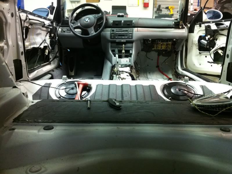

For cage paint I decided to again use Dave at Apex Autobody in Lakewood CO. Dave is a great guy and also did a great job painting my porsches roll cage, so he was the obvious choice for the M3. He does vintage cars mostly, including original RSR factory race cars, vintage exotics etc, so my M3 is not big deal for him. Once all the vendors were sorted out I started to take the inside of the car out. Here are some pictures of that process:
Race seat goes in along with Carbon fiber sunroof delete.

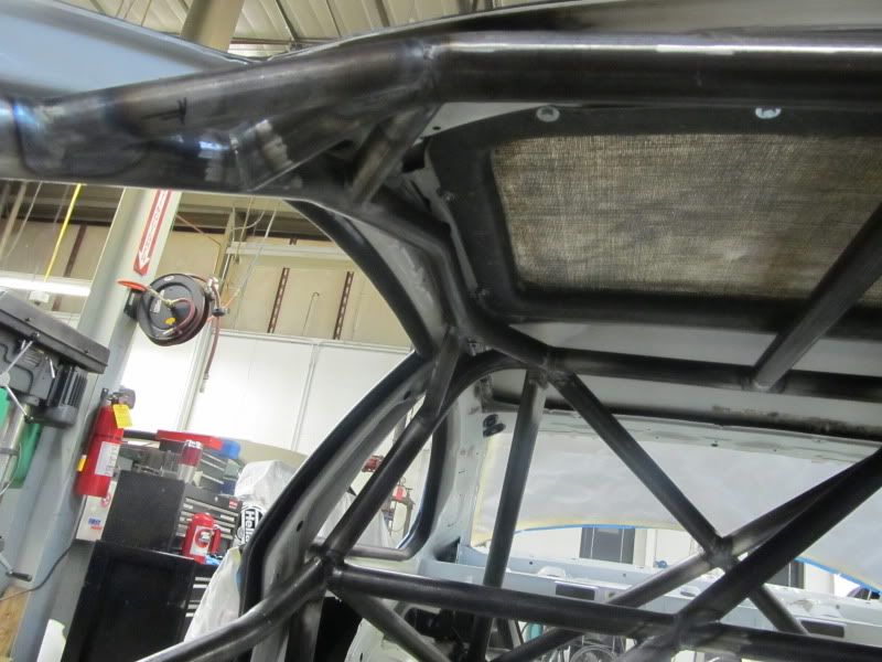

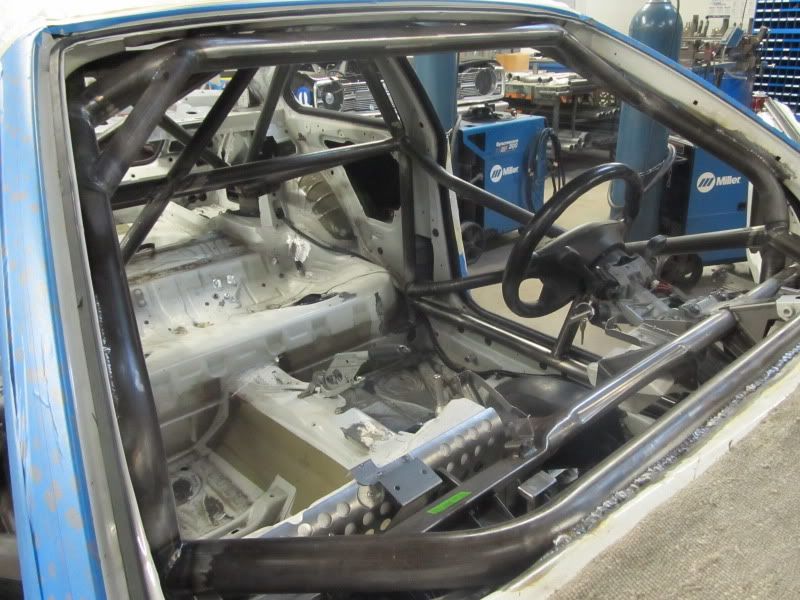

At this point all the windows have been removed and the car is ready to go to Hanksville to get a cage. Cage build pics:
Door bar starting to go in:
I opted to go with a X-bar style door bar that extended as far out as possible into the door. I feel that the more room between me and the solid object that hits the door, the better. I also did not like the excess number of bends that are present in a NASCAR style door bar, so this way we eliminated some bends, thus increasing strength, while also creating more room.
Finished door bars:
Finished Cage:
Ready for Paint!!
