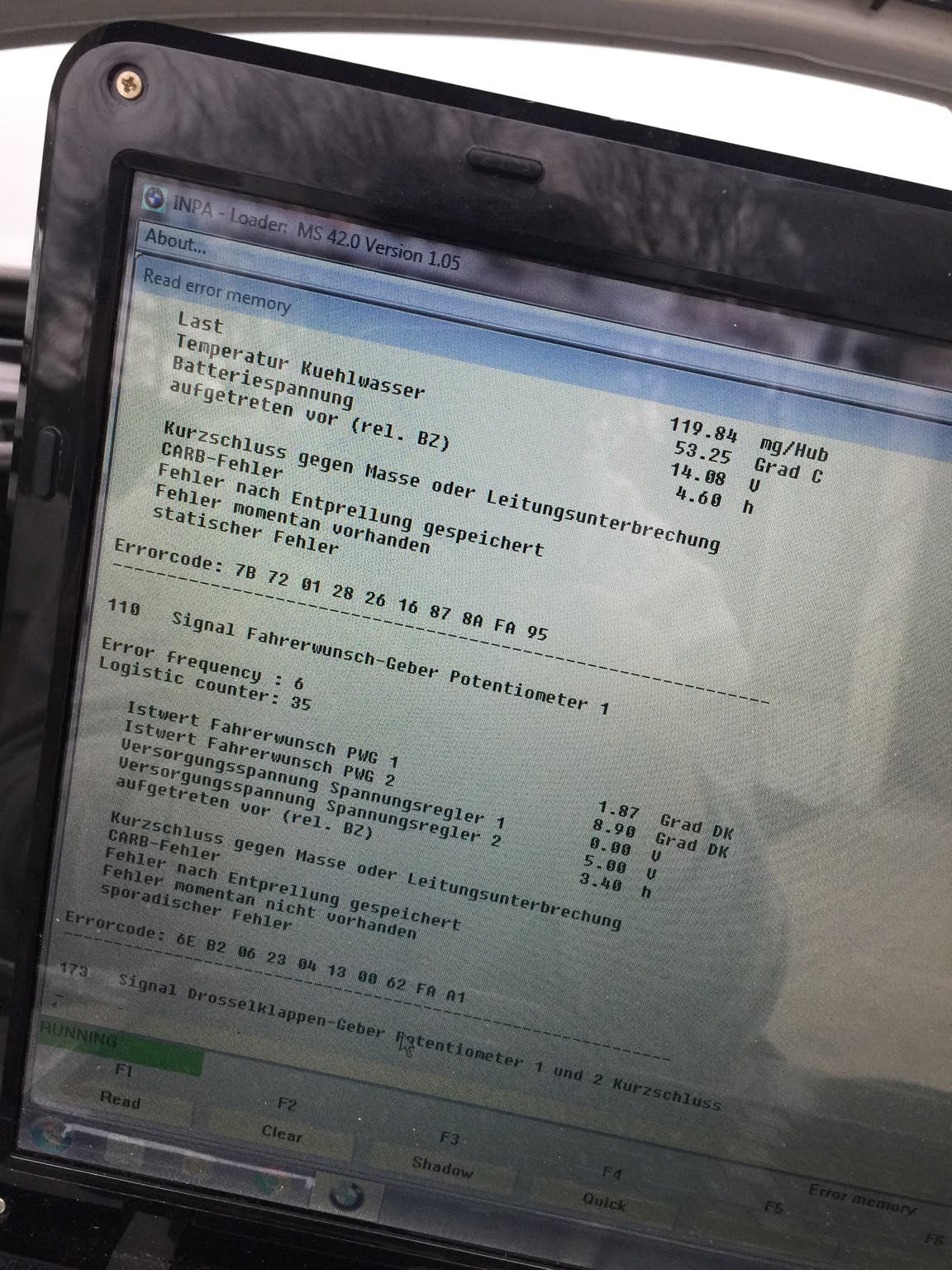

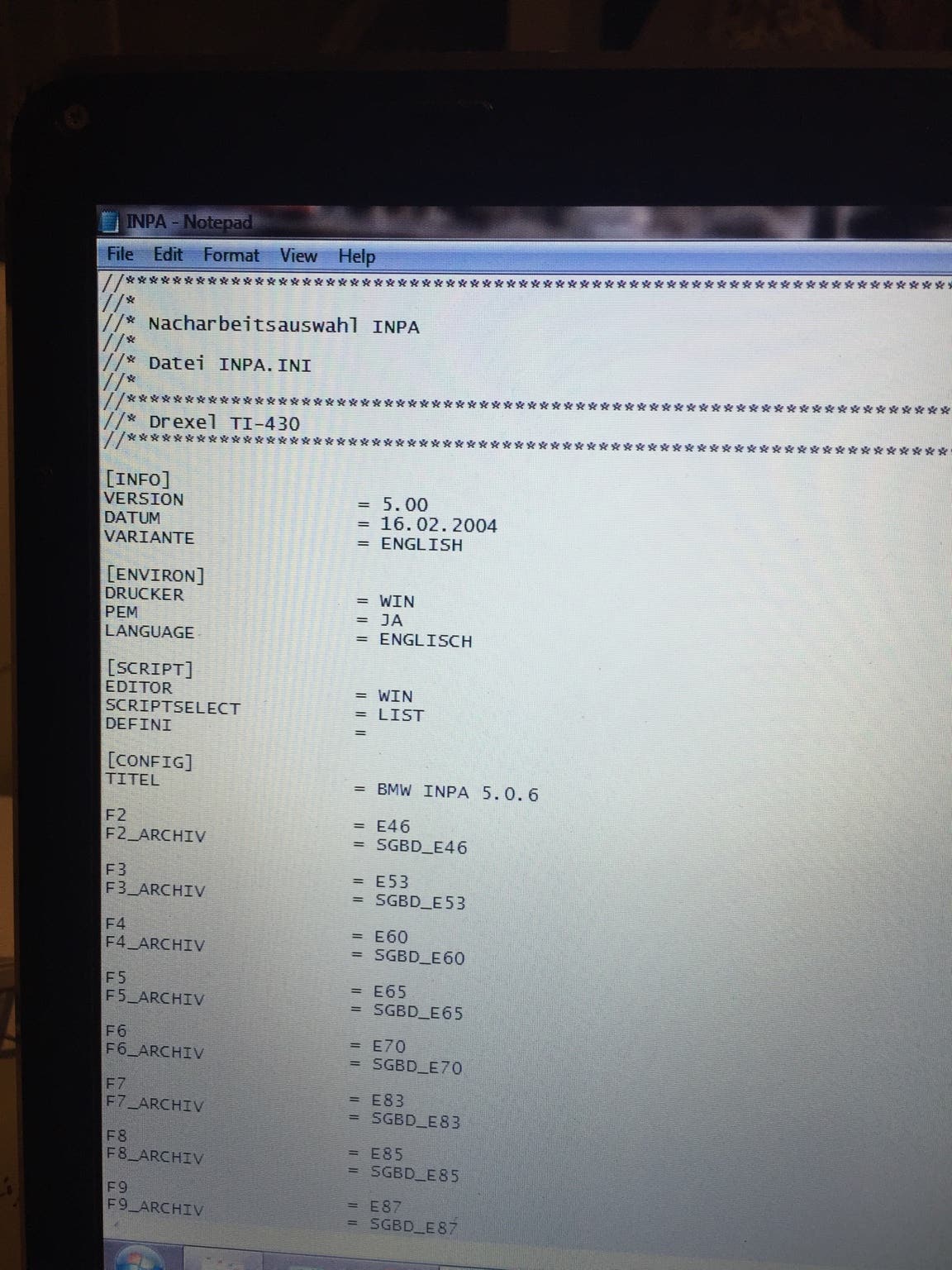

I have INPA, installed it and everything the software is in English but when I read the codes on INPA they come up in German and I don't know how to change it, I already tried going in the files and stuff and changing the language to English but it doesn't seem to work with the codes..

There is a DIY that explains how to get the older English scripts installed along with the newest BMW Standard Tools and daten files. Search and you'll find it. I will too, and will update this post if I locate it.
Edit: here it is.
http://www.e90post.com/forums/showthread.php?t=1196830
