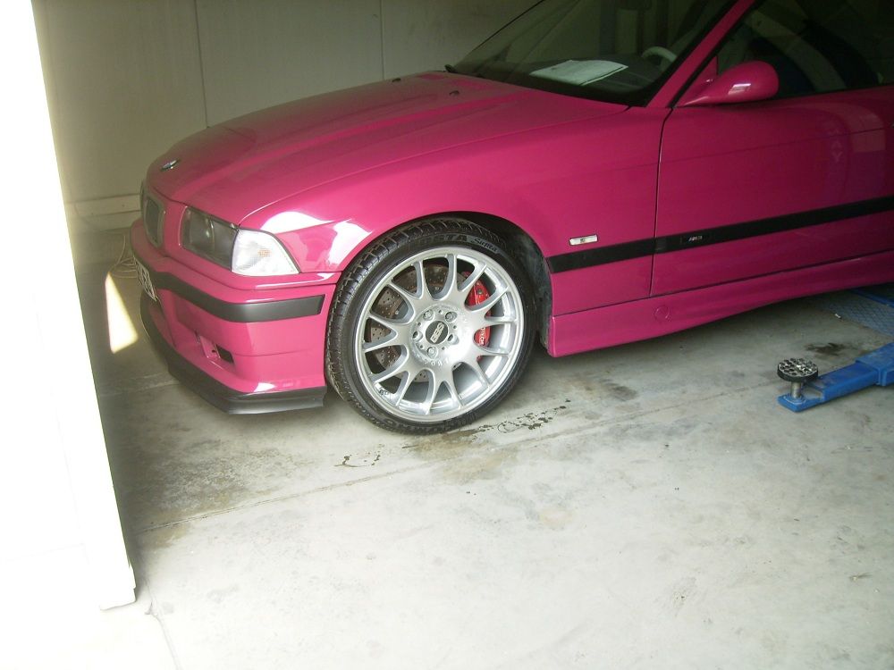

Individual paint, "fashionred 2"
Bought it brand new back in 1998.

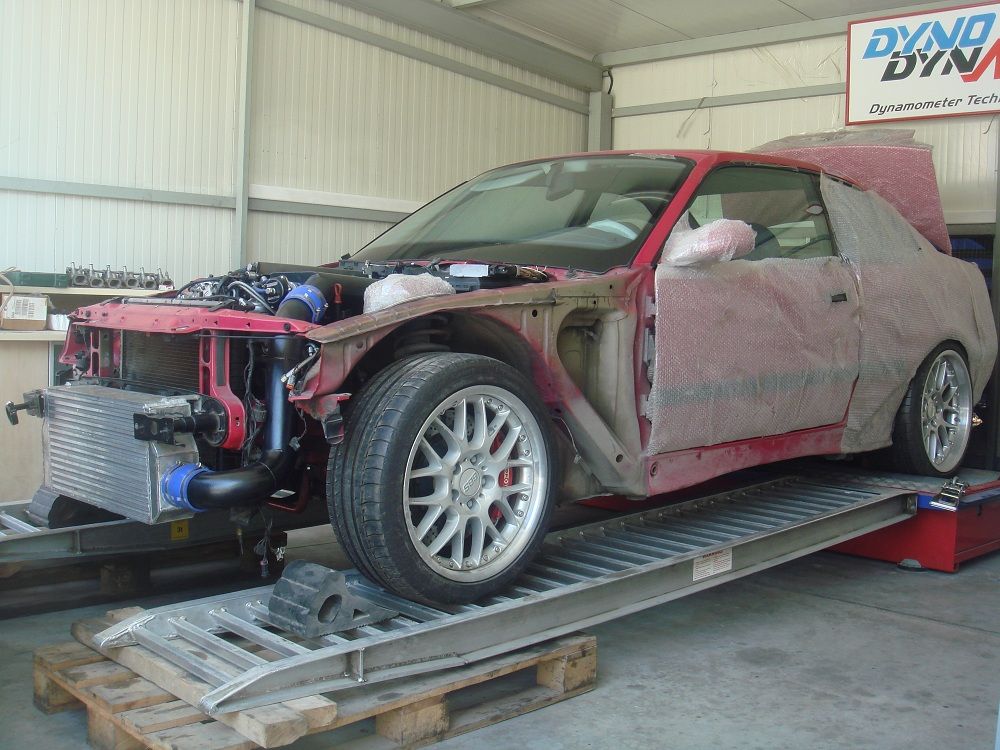

Its been under surgery since 2000 april. Supercharged in may 2000.
This M3 twin turbo went 60-130 mph in 4,49 seconds back in 2011 may. Boost pressure was 30 psi back then.

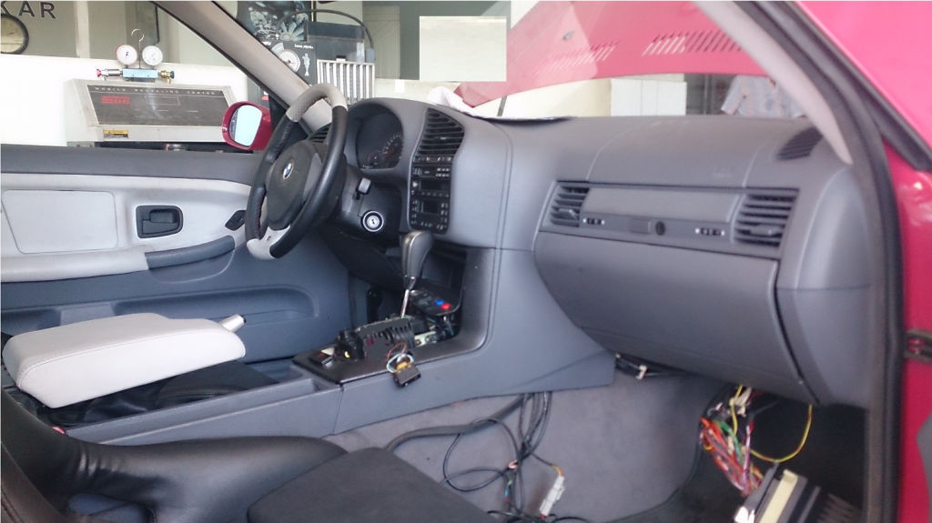

Today, we have installed a 6 speed automatic transmission and will try to go 60-130 mph in 3,49 seconds w/o nitrous. boost only.
S50 B32
twin GTX3076 on tubular manifolds
9200 rpm valvetrain
pectel
pi dash
2010 dyno days..

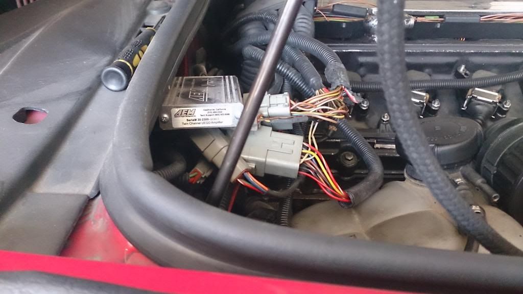

Just upgraded injectors from 212 lb Siemens injectors to Moran 325 lbs as we will raise the boost.
During my 4,23 s and 4,49 s 60-130 runs boost pressure was 35 psi. Will go up to 60 psi of boost pressure.

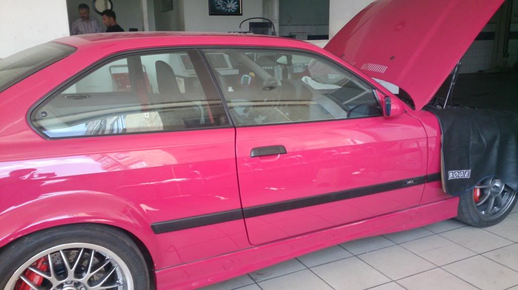

First road test of E36 M3 Euro TT
Tested new setup.
With very rich AFR 10,2-10,4 & 29 psi of boost pressure:
60-100 mph 1,87 seconds. We have very good traction.
My old 4,23 s 60-130 run had 2,40 s 60-100 mph time.
The new setup improved 60-100 mph by 0,53 s.
Tested new tires and 6 speed automatic transmission.
Sub 2 seconds 60-100 mph indicates 3,xx seconds 60-130.
Was not able to hit 130 mph, but old records show 1,75 s 100-130 mph.
Hope to see 60-130 mph in 1,87 + 1,75 = 3,62 seconds in the coming days.
100-190 km/h 3,07 seconds.
29 psi is "soft" boost, raise it 45 psi and test :)

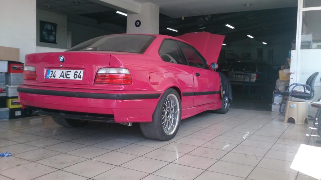

Took a 10 day vacation.
Back to real life, and keep on working on E36 M3 Euro TT and XM3 TT
E36 M3 Euro cut out fabrication, welding is finished.
Twin 3" straight aluminium pipes go into a muffler, and right before the muffler cut outs are installed.

AUTOMATIC TRANSMISSION
- shifts as fast as a modified Nissan GTR 35 or a Ferrari Italia.
- gear shift speeds are user programmable
- zero loss of boost drop during gear changes. Faster 1/4 mile times, faster 60-130 times
- hands are always on steering Wheel, more control of the car, no need to use right hand for gear shifts.
- No more stress in traffic. Just put in "D" you will be happy. Left leg rests, transmission does it all for you.
