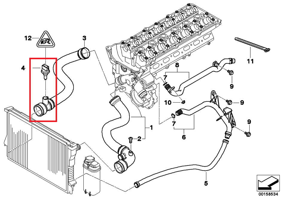

Yesterday I was driving and after I turned the heat on for the first time ever in owning the car, my low coolant light came on. I remembered reading on the forum that some had the light come on when they turn their heat on, so I turned the heat off, and sure enough the light went off. With that, I drove it home while carefully (a very short distance) watching the temperature gauge.
Once home, I assessed the situation. There is definitely a slow coolant leak. It appears to be coming from the temperature sensor (4 in diagram below, Part # 13621433077, may also be known as the auxiliary fan switch) in the lower radiator hose (3 in diagram below, Part # 11531436408).
I'm planning on making my order via the telephone to the BMW dealership nearest me (about 300km away, unfortunately).
I'm going to order an entirely new sensor with the o-ring as well as a gallon of coolant because I may as well do a flush while I'm at it.
Just wondering if you guys would have anything to add to that list.
My goal is to get the car back in operating condition for now as I need to use the vehicle for work/school.
Do not let your jimmies be rustled, though, a complete cooling system overhaul is coming in the Springtime! I don't have the time to have the car down for long enough for me to do an overhaul at the moment. I just want to get the car back up and running for now until it is an ideal time to do the overhaul.
Any input would be greatly appreciated! :)

The coolant level must have been a bit low, and once the coolant went into the heater core... it triggered the low coolant light. Fixing the small leak, drain/fill with new coolant, and bleed properly should do the trick and eliminate the problem.

I've read that while some have had success only replacing the o-ring, others have not. In the interest of getting my car on the road sooner, I'll just bite the bullet and replace the sensor, too. If I had a BMW dealership local to me and could drive my car to get parts at other places, I'd just try replacing the o-ring first, but I can't do that right now. I need to place my order at BMW tomorrow, have them ship me my coolant and sensor, then replace it. If I only buy the o-ring and it doesn't solve the problem, that'll likely mean another 2-3 business days of downtime.
#13 ·
Fixed it.
Replaced the sensor and the o-ring and the leak is gone. :)

Finding an O-ring that fits is tough to do. When I had this problem, the ONLY vendor of this size O-rings I could find would sell them only in lots of 144, which, with shipping, cost more than a new sensor.
If I ever have that problem again I will first pull out the sensor and wrap it in teflon tape and put it back in. Who knows? It may work.
I tried to measure the original O-ring, and as nearly as I could tell it was:
Original O-ring Inch
ID 8.2 mm 0.323
CS 2.6-3.2mm 0.102
OD 13.4 mm 0.527
I was measuring a 5 year old O-ring, so the cross-section was flattened a little, and cross section may have shrunk a bit, ID may have stretched when I removed it.
