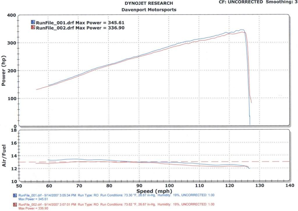

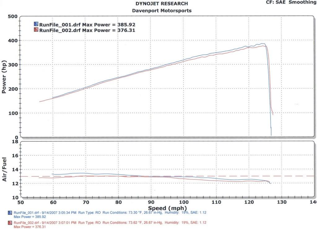

So here's my Dyno from a month ago. Not really happy with the results, paid a lot of money for 50-60whp, assuming stock is 290whp or so ??? The following would be the main factors:
  1. Altitude 1100m / 3500ft
  2. Secondary air pump on car is broken, waiting for replacement part from Germany.
So the first dyno is CORRECTED and the second is UNCORRECTED. No wonder the Dinan non-intercooled car that was on our track a while back walked on me...
PS: they could not get the TAC signal, so hence no torque, just mph.
What could be wrong here ??

A Dinan Non intercooled car is not that fast, with the power made, you should have took him regardless, so that doesn't make sense.
Something is not quite right, did you ever get a boost gauge installed? Your AFR is okay, but looks a bit off IMO should be a little fatter up top.
Install a boost gauge that will tell us more. You could have a slight boost leak, there's a few areas of possibility. Check boost 1st and report back. Corrected you're not too far off fromt the 395-408WHP everyone else is getting with 5.5 psi. Did you get a reflash for the new rev limit yet?

yes, a temporary boost gauge installed by my tuner revealed i was boosting between 5-5psi, no problem there.

385RWHP isn't far off what all the other Stage 1 VF cars are getting, especially since your at a pretty high altitude and have the lower rev limiter. In fact, I would say those are good numbers.

Actually, 385 isn't bad for the VF setup. Did you run a stock baseline to compare? Stock isn't normally above 290whp unless its a Euro M3. Normally it is between 275-285rwhp on a US M3, so you are seeing 100whp more correctly.

Here is what I'm confused about. The 2nd dyno is uncorrected? Most of the time doesn't the uncorrected dyno read higher? Please excuse my ignorance b/c I don't know much about this stuff, but even then that's a big 40whp or so difference btwn the two dynos.
Since you really have nothing to lose here. First reset the adaptations. Also I'm assuming that the VF stage I runs the stock MAF. Perhaps you should get some MAF cleaner and clean it while you are at it.
Another problem I have read about people losing power is in the fuel filters. Check that to see if its clogged. If so replace it. Also keep in mind that there are not many M3's that dyno 290whp stock! I highly doubt there are that many, and if they have the dyno may be one that reads higher than others. A more realistic stock rwhp on a stock m3 is on the low end 265 ish and on the high end in the 280s. Avg. being in the 270 range. So if you are making 385 whp that about 100 whp from 5.5 lbs of boost. That if you ask me is pretty damn good for the 7-10k you paid for your SC with install and whatnot. Comes down to at least 10whp per 1k spent.
9,566 Posts
Correct is usually higher. Since he is at higher altitude there is less dense air, hence less HP. When corrected, I think it puts it to sea-level which has much more dense air, hence the higher number.
He is being corrected for sea-level (IIRC) elevation.

^^ yes, I am being corrected to sea level on the 1st dyno above. And yes, air is a LOT thinner at 3500ft !! I was told that even NA cars lose hp up here, maybe even more ?
