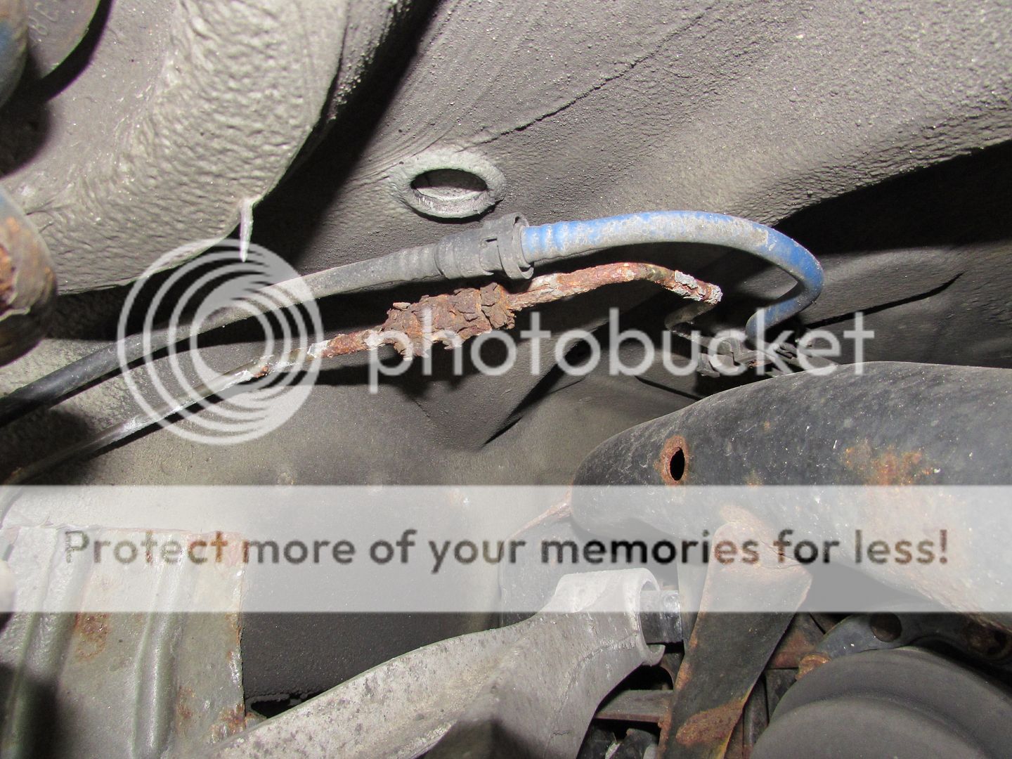

I happened across this sweet little spot while I was under the car inspecting a knock coming from the rear (turned out to be due to RTAB limiters).
This is the rear brake line that comes from the left of the car, and crosses under the car behind the diff and over to the right rear caliper, I believe.
From the looks of the OE diagrams, there is a union here at this point for some odd reason. You'd think that BMW would put a union there so that if the rear line rusts out of becomes damaged you could just replace that section and not the entire thing. However it appears from this picture that it was the union that started rusting in the first place which then spread to the line. The rest of the line is ok.
Never did brake lines before, but have a buddy willing to help me out, he says that this can be a lot of surface rust and line is still probably ok for now underneath. Not wanting to really chance having my brakes go out, but trying to determine how long I should wait before addressing this. The line is not expensive, it's the precise bending that is the PITA here, and I am not 100% sure where the heck this connects up front, as it may go all the way to the DSC box, and that would just make things worse. Anyone ever deal with a rusty line like this on an E46?
Any advice other than the totally obvious: "Man that looks horrible, get that fixed asap!"

OK, down to the real questions. I'm sure a lot of folks will freak out about it, and I did initially, but having been in the rust belt for a long time, I can step back a bit.
You may NEED to get it fixed NOW, but if I were faced with your situation, here is what I would do: Get some Evaporust (it's not cheap) and soak an old T-shirt with the stuff and then wrap it around the brake line (maybe even wrap the T-shirt in plastic wrap). Let it sit for a weekend you don't have to drive it. Come back and take a look at it. You should be able to get a better picture of what you are really dealing with, but this doesn't look so good.
I'm less concerned with the corrosion on the fittings than I am with the corrosion on the lines. The fittings are thick and well sealed, so they are not likely to fail (until you try to take them apart). The failure is likely to come on the thin brake lines. They don't look too bad at the moment, but some Evaporust will give you a much better idea.

I would get a nice "line wrench" for this job. I think it's 14mm. It may be tough to get the brake line out of the caliper if everything is rusted- try loosening it with the caliper still in place. Hopefully the next junction up isn't as rusty and it comes apart for you.

Was quoted ÂŁ600 from a BMW indy for a 15 year old E46 to have the rear pipes replaced. In comparison to pictures above, they were not as bad although many parts of the piping seemed quite solid. The connecting bends, which is what the mot tester sees were corroded. Its a safety thing first anyhow.
High Cost is due to labour involved as fuel tank needs to be dropped if it is to be done the proper way.
Got it done for ÂŁ250 including the copper piping and fresh brake fluid. Was still umming and erring but a burst pipe means no brakes and not about to take that risk. Possibly could have left it but then an mot failure may have forced to do it.
I viewed them whilst on the ramp myself and that was enough to just get it done and then forget about it.

I had to do the drivers side rear line at about 204,000 miles about 4 months ago. I had to panic brake for some baby birds and next time I touched the brake it went to the floor... I drive a manual so I was able to limp back to my friends house with lots of engine braking and carful manuvering...
Cut off line where it seems to be solid, disconnect the rest going to the caliper. Save the fitting going to the brake caliper or buy a new one, and scrap the old line. Pick up a good brake flare kit, not a crappy one from harbor freight, the cheap ones just don't work... Grab some brake line and the right size brake union fittings at auto parts store. Put the fitting on the old line first, give it a flare. Cut a section of brake line that matches the old peice and put the metric caliper fitting on and make a bubble flare. Place the other union fitting on the other end and flare that side as well. Connect the two with a threaded connector and bend the line to fit. Nothing fancy, just don't want it hitting on things or getting crushed by the suspension travel. Bleed the system and check for leaks. No need to do the whole line if just the rear section is messy. It is an hour or so of labor vs a whole weekend or more to do the entire line... At that point I would do them all and replace the calipers and soft lines and do a full on restoration.

Upon inspecting, there were parts of the line that didn't look as healthy as others and the mechanic actually changed line to the front. Kind of pushed him if he was going to drop the tank anyway. Although as you have done was an option. Can hopefully forget about it as just want to drive the thing hard but responsibly.

I did the rear pipes they looked exactly like that it snapped with one bend applied to it
