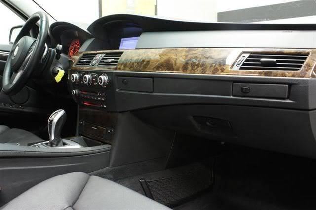

Did anyone think of this as yet?
I like the new style selector knobs. I was wondering if anyone is brainstorming a retrofit idea for it. I'm sure it would be either expensive or very darn creative to do.

So I'm about to break this 2009 550i shifter apart and see about fitting it inside my shifter boot. Using the thread on bimmerforums where the DIYer wire the 2008 M6 SMG shifter into their E46 M3s as my guide.
I'm finding it difficult just to seperate the new 550i shifter from the transmission anchor. Also I'm beginning think I should've gotten the other style Sport Shifter where there is a leather boot wrapped around the base. This one seems to be one long continuous device.
