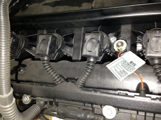

After week holiday and not driving, last night when i turned my car on to go to the shops i could smell something wrong under the hood. Opened up and this is what I found.
Is this a VCG issue or something else. Whats bothering me is that the oil is leaking underneath the screws not around the gasket ?
201 Posts
Definitely VCG. There are seals under those screws. New VCG but I think you have to order those separate as they may not come with VCG.
581 Posts
Definitely a VCG leak. Takes about an hour, maybe 2 if you go really slow. I've heard to avoid Victor Reinz
