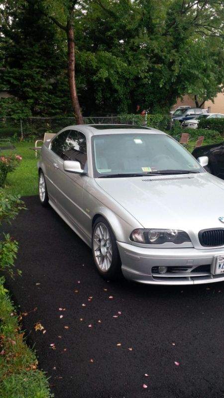

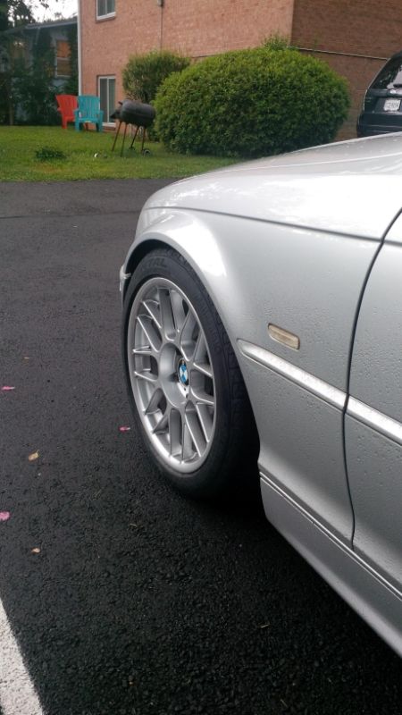

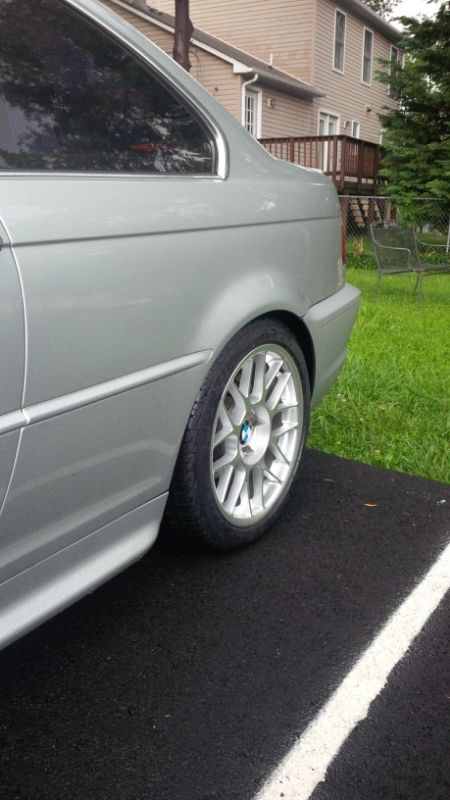

#31 · (Edited)
Not the greatest picture, and it was right after installing a Street Edge coilover kit. Front still has to settle, and has almost another inch left to lower on the adjustment on top of that, so take that as you may. Rear Springs are just a tad lower than stock spring height, I wanted to let the front's settle before I adjust all over.
17 x 7.5 et40 Sport Edition F6 wheels all around, with 5mm spacers on the rears.
New Hankook Ventus S1 Noble2 tires (225/45/ZR17) all around (a week old at this point lol)
And, as said, sitting on a freshly-installed, as-of-yet-to-settle, Street Edge coilover kit.
Stock everything else, fenders untouched. I know I'm not nearly as aggressive as everyone else that's posted. I'm gonna go down maybe another inch when all is done, and that's as far as I intend to. Just how I like it :)

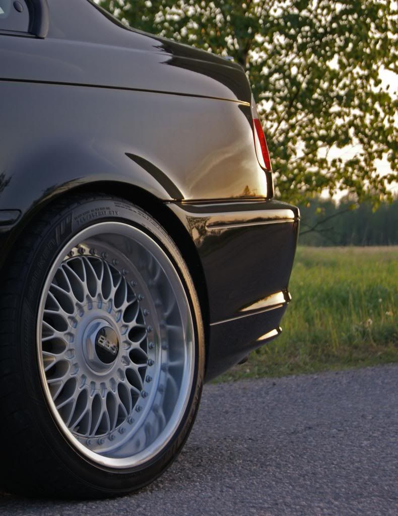

#34 ·
Hi guys,
I want to put 17s bbs reps as the pictures shown. But where i live, streets are not good. I want to put some tall tyres for not braking them everytime.... Standard height for now. Wich offset and with should be the rimms, and what tyre do you recon it can look good, being a bit taller than common? I domt want any fender rolling....
