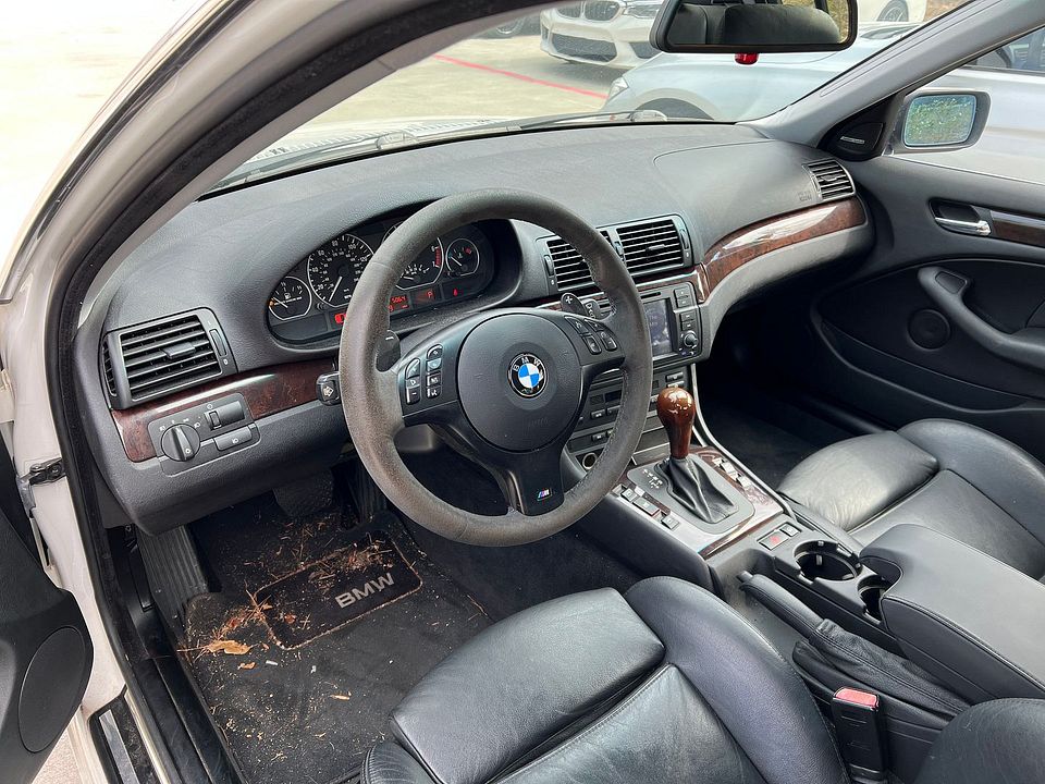

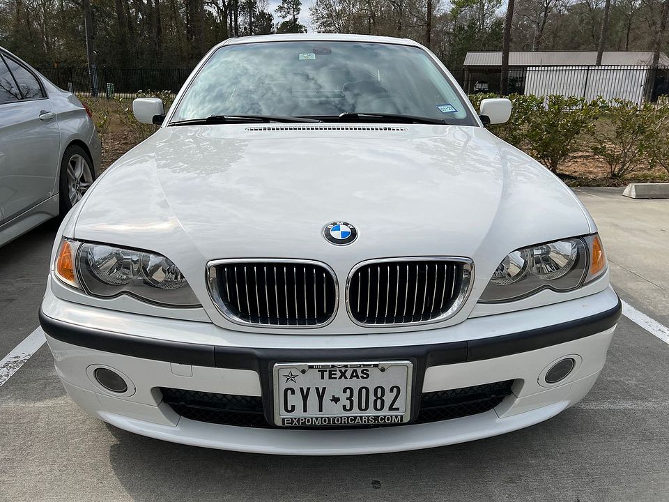

Here are some pictures of the day I took over, February 2023.

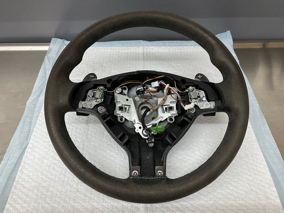

Then pulled the alcantara M3 steering wheel off to clean the previous owners hand gunk off of it. Steam cleaner and some degreaser works wonders, followed with some 1000grit sand paper to take care of the pilling, Came out nearly like new.

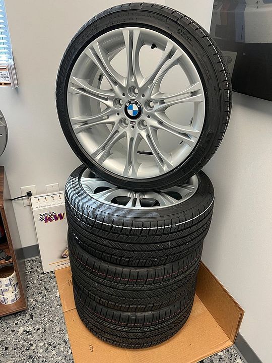

The parts car had four dead tires, with sun beaten Style 135's on it. Never been a big fan of Style 68's my car came with, nor will they clear the brakes.... so I sent the 135's out for refinishing yesterday. Got them back today and man they look scrumptious. Color is a perfect factory match although the tonality looks off in these photos.

Today I got the new tires mounted on the Style 135's with our Hunter Auto 34S, roadforce balanced and topped them off with new ///Mblems and center caps.
They look quite nice in the corner of my office all up in my personal space. I try my best to keep my crap out of the primary shop space to be considerate to the techs buuuuut I've got quite a few piles going at this point.
