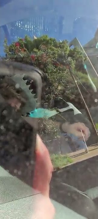

One of the other issues was that the car refused to get to temp unless you particularly laboured it up a hill or sat in traffic for very long. BMW Thermostats are designed to fail open…. Well that’s not what happened here.
Please keep in mind, everything removed off the car up until this point has all been OEM parts. OEM Tensioners, Wheels, thermostat, PCV etc. So these parts are 18 years old with ease.
On the thermostat housing there are two tabs that hold the thermostat in the housing – these tabs had completely broken off. This left the thermostat to just float around in the housing doing nothing. The tabs were not found so we assume they in the radiator?
Old broken housing:
New housing with new thermostat:

Issue 5:
So this was a bit of a fuckup and entirely because I knew it was going to happen, I had done the research and needed to just action it and did not get to it.
I got the car with one key. Red Flag 1.
They key did not operate the central locking. Red Flag 2.
The key locked and unlocked the car only via the door barrel. Red Flag 3.
Aware you could get uncut keys that just needed coding for like R400 it was never a thought that the door barrel would break. Until it did, with no warning what so ever.
With no way to access the vehicle I had to find a way without breaking a window. Using the key I opened the boot manually, removed the carpet covering the panel between the boot and back seats revealing the ski hatch. BMW has a retrofit for this which allows you to fit a ski back in that space….. So of we go, kick that bitch out.
We then (and by we I mean my mate Luc), I was no use at all, I just laughed the whole way through. We then tried to open the doors from the inside but found they were dead locked. Using a rake to reach the unlock button was equally futile, it did nothing.
Alright, so locked out, doors don’t open, buttons don’t respond and neither of us could fit through the ski hatch….. The solution? Borrow a little person.
Called up a client of mine in Clifton and asked if I could borrow her 8 years old daughter (wont be posting a video of her 007 espionage efforts getting in mostly because its hilariouis and not appropriate) to pop the ignition and unlock the car. She was rewarded with the biggest slab of chocolate I could find.
Ski hatch looking like a hooker on Claremont Main Road…
The next morning I popped in at Bruce Craig Spares and dealt with Nate, who was absolutely brilliant who then proceeded to repair my broken door barrel in all of 6 minutes and then cut my key open, soldered in a new battery and repaired my central locking – I think you can hear my excitement and happiness. Massive shout out to Nate, he was excellent.
