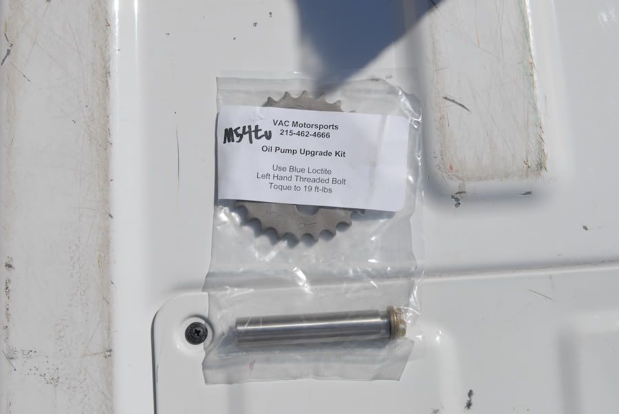

Another solution that many try is from VAC Motorsports for $200. They offer a kit with a new sprocket and oil pump shaft that must be pressed into the existing oil pump housing. Here's the kit:
Here the VAC Motorsports shaft has been pressed into the oil pump housing:
And all buttoned up:
Note that the bolt is a reverse threaded, and was installed to VAC's specified torque, and additionally we added Loctite Red to the threads.
I would love to report that this simple solution works, but it didn't in my engine. When the engine was torn down after approximately 80hrs or run time, I found the bolt loose to the touch, and the sprocket somewhat wobbly on the shaft. Based on what I found, I would say that it was just a matter of time on my engine before the oil pump drive sprocket came off. I have also heard from numberous other people that have installed this kit, on M54s, M52s, and S52s, and have had oil pump failures. It may allow the oil pump to last a little bit longer than the OEM piece, but eventually it fails.

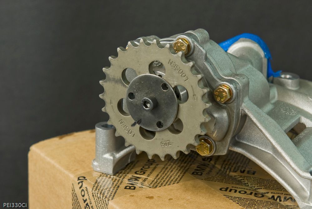

I decided to try a solution that Greg Smith ran on his car, and isn't commercially available, but if you ask nice he can source one for you. The price is more than the VAC Motorsports solution, but much less than the BMW Motorsports solution. What you get is a completely new OEM oil pump housing and internals, with a specially machined drive shaft and sprocket. I would say most of the cost is in starting with a brand new oil pump core, but I'm not complaining. This is one very nicely put together oil pump package:
Taking the sprocket off, we can see what makes this solution so special:
Yes, that's all one solid machined piece that the sprocket bolts to:
From a piece of mind perspective, I think this solution is a bargain.
