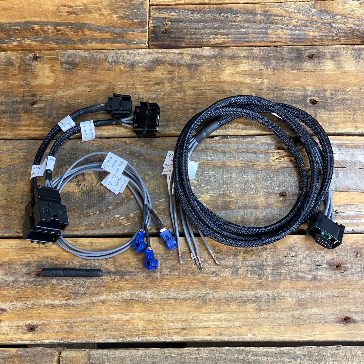

-Wiring harness adapter

Hello, I just stumbled upon this post and I've actually done this swap in my own e39. Moving from an m52tub28 to m54b30. All I had to do was swap the oil pan and intake manifold to make it fit.
Keep the wiring harness, and everything else, and hold onto your old accessory parts just in case your new ones don't want to work as well.
The oil pan had to be swapped from my old motor because the donor motor was out of a z3 but if you're taking it out of another x drive vehicle, it should be fine.
And the intake manifold had to be swapped for mine because the throttle body of the m52tu is drive by cable, and the m54 is a drive by wire, but the main difference is that they use different mounting patterns. There's an adapter sold by bimmertune that makes it so you can use the m54 manifold on the drive by cable cars: Adapter | M54 330i intake manifold upgrade on M52 TU
