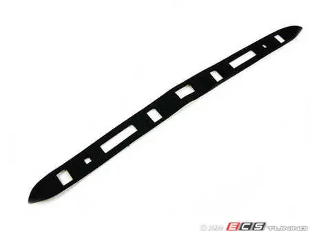

I have the same LED housings as you and I also had the same corrosion issue. I had to replace my bulb holders eventually inside my handle assembly as the tabs just corroded away. The problem is in the gasket for the trunk handle. Water is getting into the housing through the failed gasket. Grab a new one from ECS Tuning or FCP Euro and you should not have anymore issues with water getting inside the housing. Less than $15.
