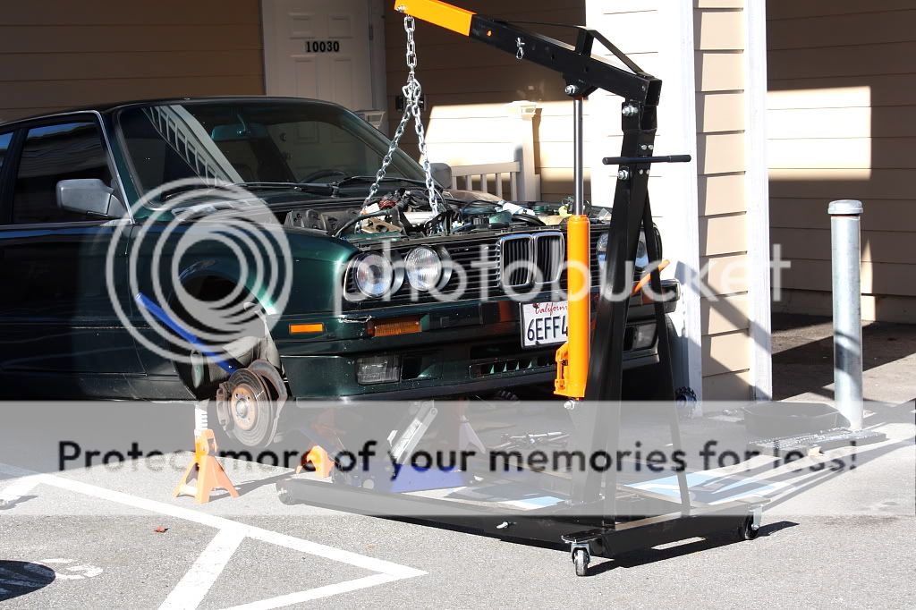

But there was no way I was going to do that in the carport at my apartment (and believe me, I was tempted since I had already changed the motor in the E30 there).

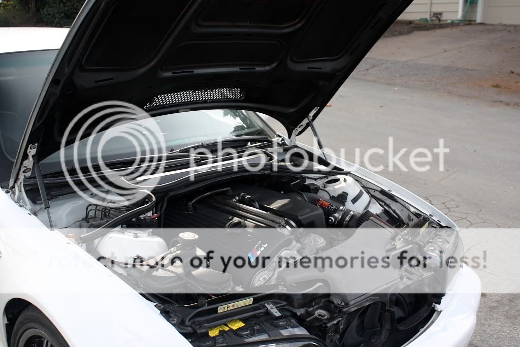

So I moved to a small house with a big garage and as luck would have it, found an M3 for sale with a blown motor. Perfect rolling test stand, right? I had to pop the motor in to test it out:
I learned a lot thanks that car and I felt ready to start working on the sedan. Unfortunately, projects came up, the house was torn down and I had to move yet again, so the swap was derailed once more. On the bright side, I've been using that M3 as a beater for a year now!

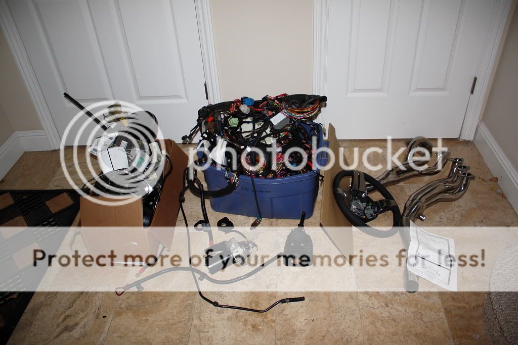

I had already accumulated a lot of the parts to do the swap, but I still needed to pick up many small items that fit in between the big components. The main areas that I needed parts for were:
