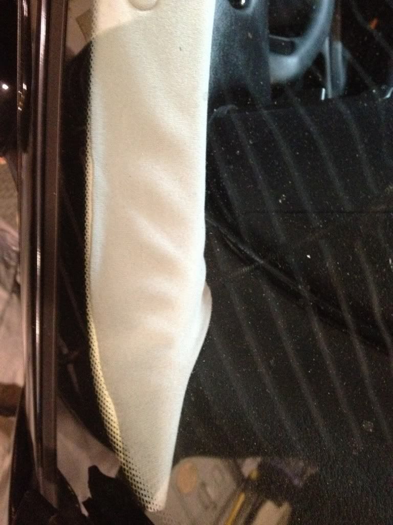

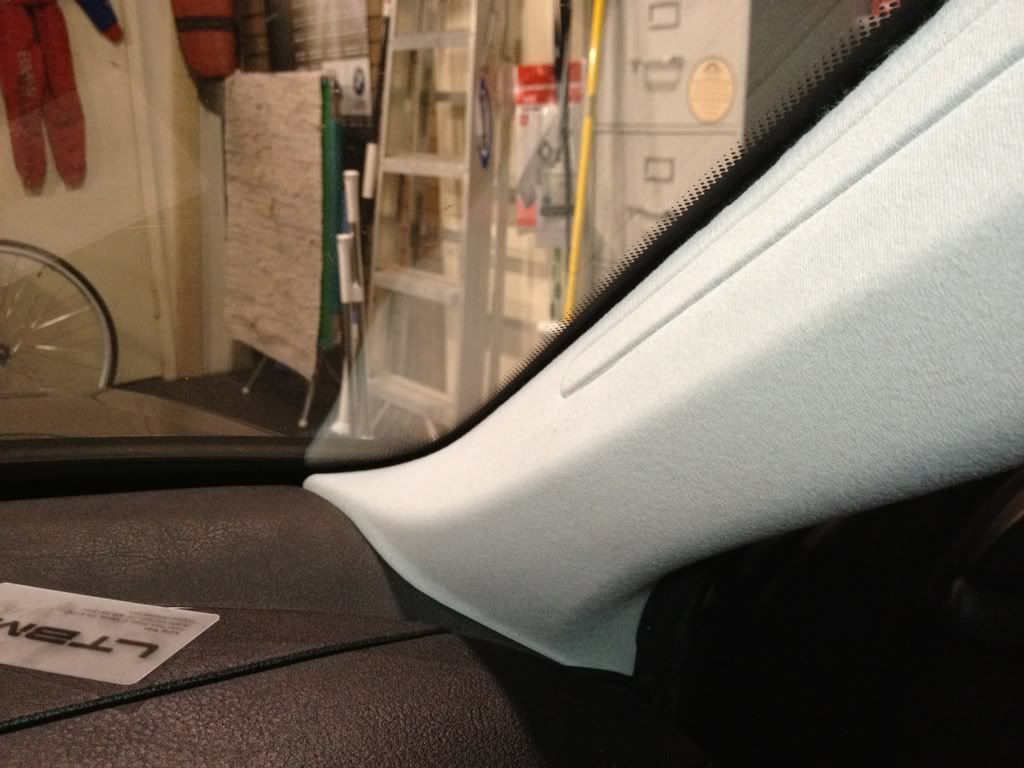

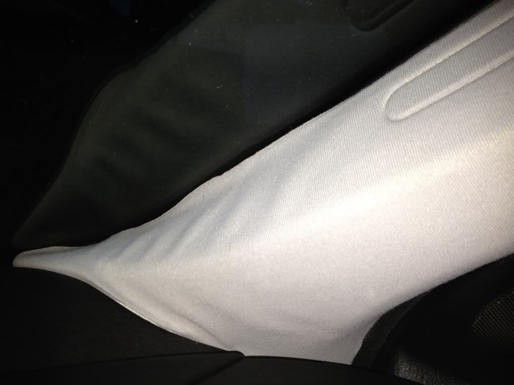

This might be a repost, but I just did this the other day and the result is great.
So I don't know if you guys have the same problem with your non-garage kept e46.
PROBLEM:
From inside
from outside
SOLUTION:
RESULT:
From the inside
From the outside

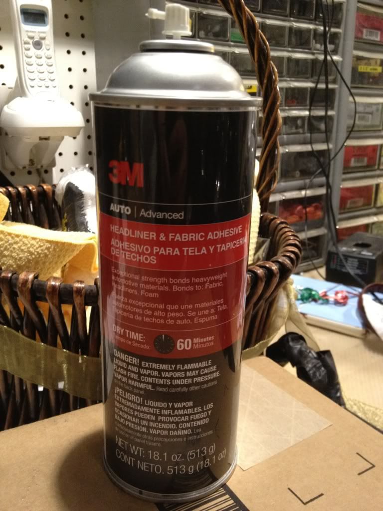

I just checked my own thread and I found it quite misleading just by looking at the pictures.
So you do have to remove the A-pillar covers to apply the 3M adhesive. And I got the adhesive from either autozone or pepboys.

How much adhesive do you have to apply? When I tried this the headliner didn't stick and it just left disturbing looking stains..
Sent from my ADR6425LVW using Bimmer App
So i first peel off the corner of the cloth(headliner) off the A-pillar cover.
spary on the A-Pillar cover not on the cloth!
then wait for around 10 minutes and wait until the adhesive to dry off. It has to be dry or the cloth will soak up the adhesive(liquid form) and cause patches of stain.
After its dry, the adhesive should turn into a thin layer of dry glue (dry foam form), like the sticky side of duct tape, then you can slowly apply the cloth (headliner) back on the A-piller cover.

Well, that's more of an A-pillar problem than headliner, but yes, that is a good, cheap fix. My fix did not last long, and I did it twice. Hopefully yours will last longer. I'm just gonna buy new ones.
Though, that 3M headliner headliner adhesive I have never seen before. Maybe it is better than the stuff I used.
I dont understand what you mean by it's an A-Pillar problem?
and if you get a new A-piller cover, the color wont match unless you have ZHP or M3, aka Anthracite headliner.
