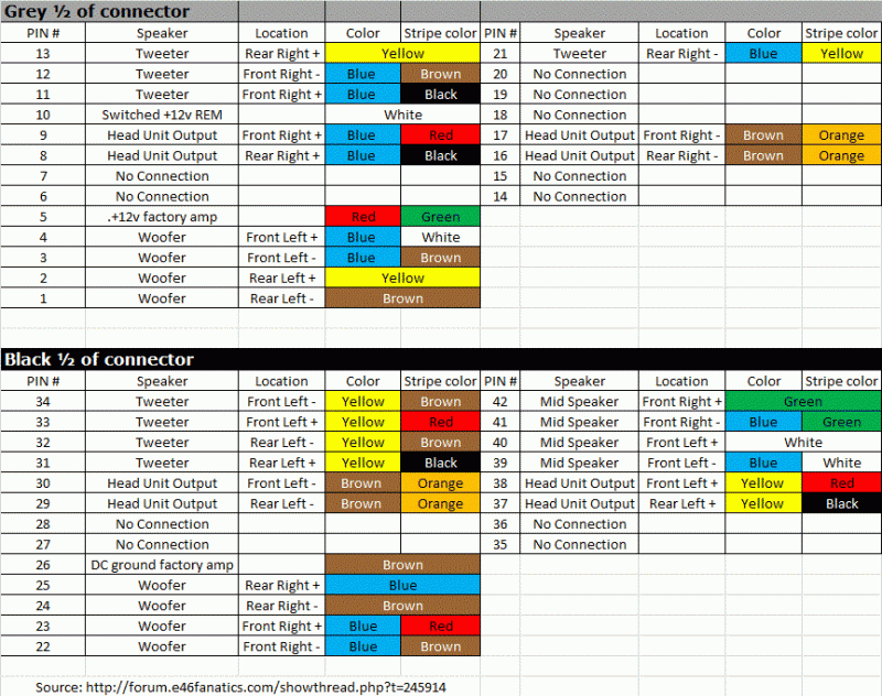

Once the amp is acquired, wire it in from the Head Unit output using this wiring diagram:
(not my work, I rehosted it- awesome chart btw)

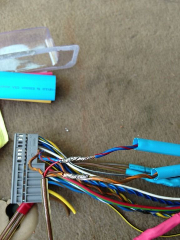

And start splicing in your RCA wires into the factory harness (which can be found here)
For the rear I spliced directly into the rcas as such:

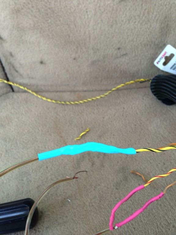

(double heat shrunk ftw)
and for the front I went ahead and just tapped into the signal (either method is fine - however I'm not using the fronts, it was just an accommodation for down the road)

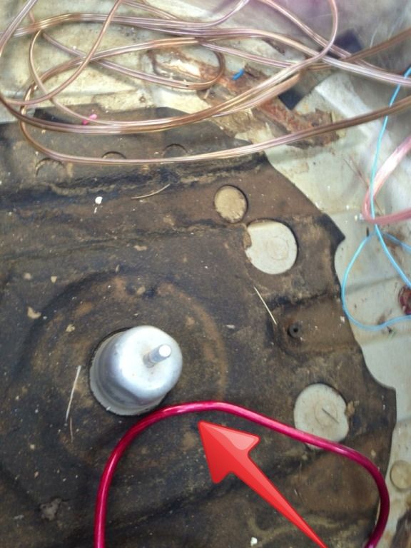

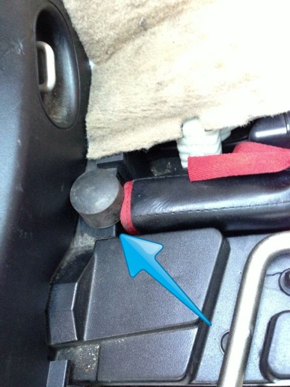

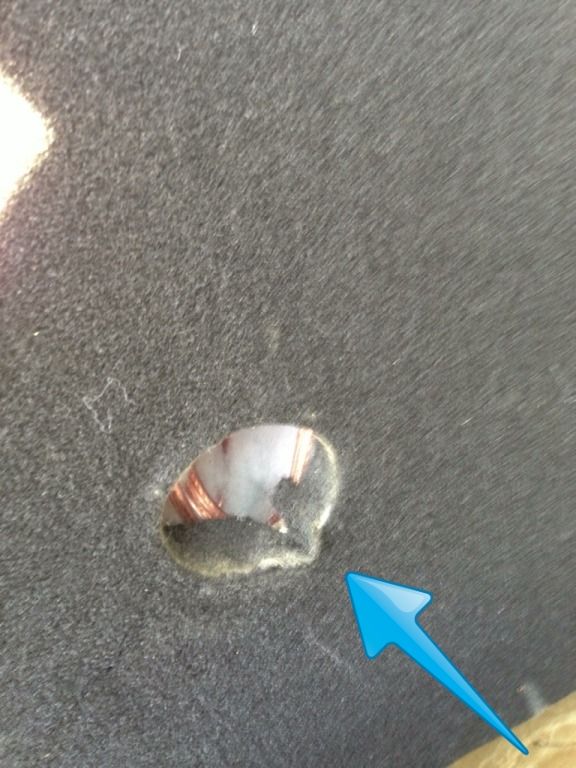

Then I noticed that this guy:
Is the same diameter as the pre-made hole for the speaker connections:
(I carved out a little cavity to allow my wiring to pass)

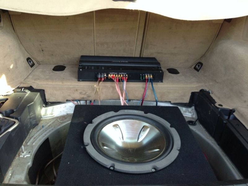

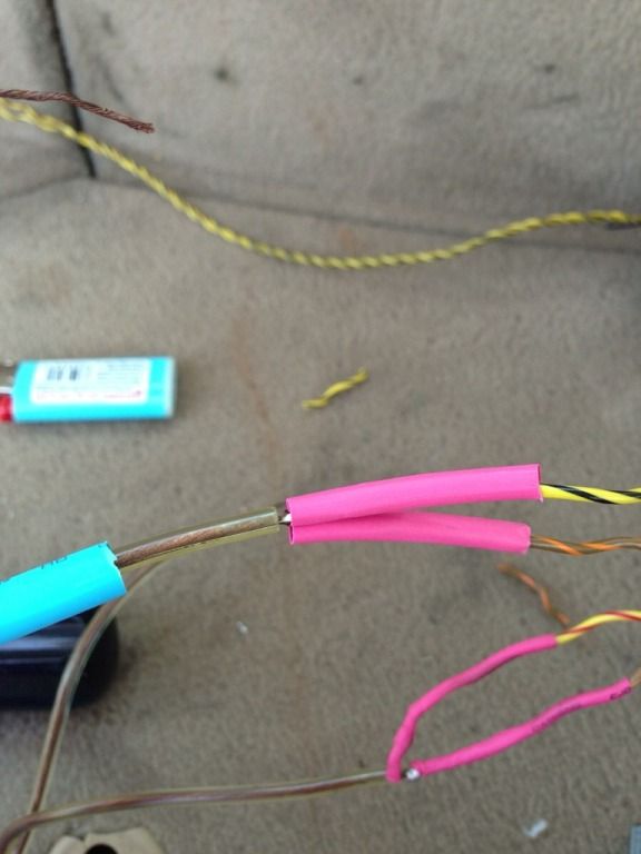

Once installed it fit beautifully and even allowed me to install the amp directly in front of it (had the amp out for tuning purposes in the picture)
Even though the cover does fit flush, it kills a good bit of bass when it's in, so I spaced it out until can get around to cutting some sort of port to allow the air (bass) to travel into the cabin
