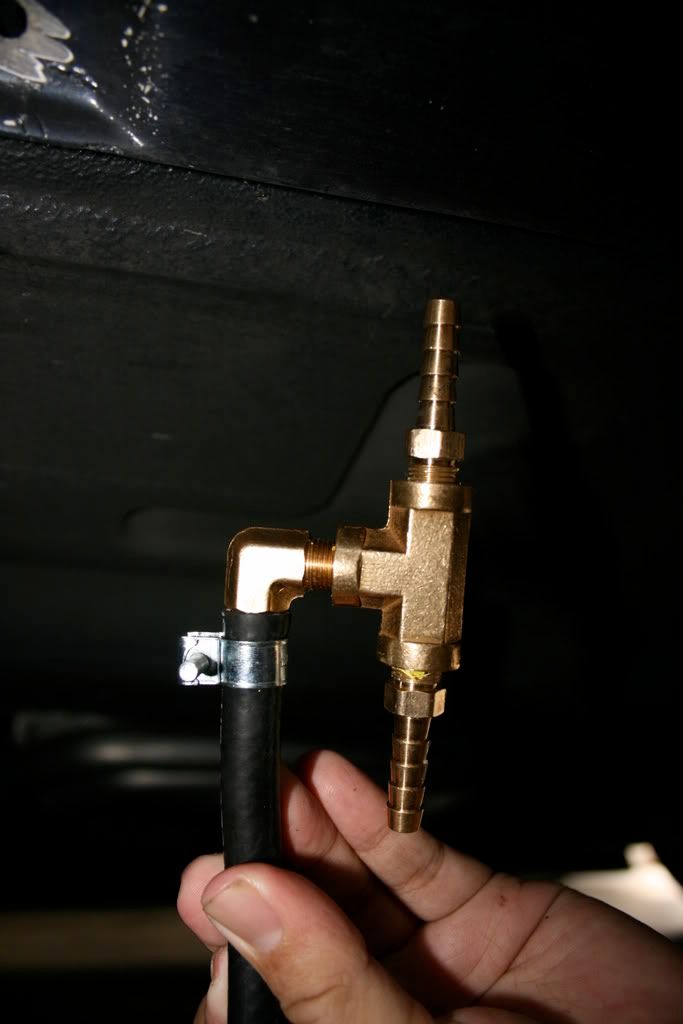

Wait a minute, you say that a wet shot kit will shoot both fuel and nitrous into my manifold at the same time...where does the fuel come from!? Is it magic!? I LOVE MAGIC!
It's not magic...you have to tap into your fuel lines. Most kits will come with some sort of fitting to tap into your fuel rail (the test port)...however, I have lovely carbon fiber engine covers that would be rendered useless had I gone that route. Luckily a very creative promp3 created this little contraption out of some hardware store fittings that tapped into the fuel line just before the fuel filter.
