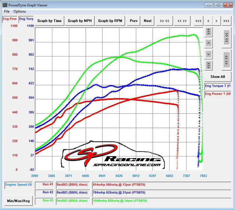

PTE 6870 CEA GEN2 Results:
6870 CEA GEN2 Various Boost Levels (HP and TQ shown):
614whp 506wtq @ 13psi
784whp 625wtq @ 21psi
1046whp 855wtq @ 34psi
6870 CEA GEN2 (HP and TQ shown):
http://www.youtube.com/watch?v=8fBcqRn2b_Y
Compare:
**Note: This is definitely not an apples-to-apples comparison. We pushed the car harder running higher boost levels once the 6870 was put on. We're just showing a ball park of how both turbos size up against one another.
784whp 625wtq @ 21psi 6870 e70
967whp 738wtq @ 31psi
678whp xxxwtq @ 18psi
740whp 624wtq @ 23psi 6766 e52
859whp 710wtq @ 29psi
Good info here, but not apples to apples. Would love to see same fuel/boost. Thanks for posting:thumbup:
72 Posts
We have tested these turbos on the same car with same fuel etc while the car was never unstrapped from dyno. The 6870 makes about 100 more hp than a 6766 and the lag difference is 125 rpm FYI
155 Posts
What is the AR of these turbos? Divided or undivided housings? Just trying to account for all the other variables that may not have been displayed. No doubt the 68 is making good power. QSV on this car?
81 Posts
Discussion Starter · #8 ·
No QSV on here, we couldn't fit it. Both turbos has T4 undivided .81 A/R housings.
81 Posts
Discussion Starter · #10 ·
Thank you, that car is a beast.:thumbup: I remember you doing a QSV on one of these cars, what exhaust manifold was used to get the QSV to fit?
That was on an FSR manifold. I remember it being a really tricky thing and we didn't end up keeping it on there. We also had to modify the QSV quite a bit. We'll see if we can work something up in future builds. The QSV is really a huge help!
155 Posts
Any insight on where the clearance issue is/was? I assume it was the block? The nitrous can be used for spool and other things. :evil: Is it worth having a qsv with nitrous?
