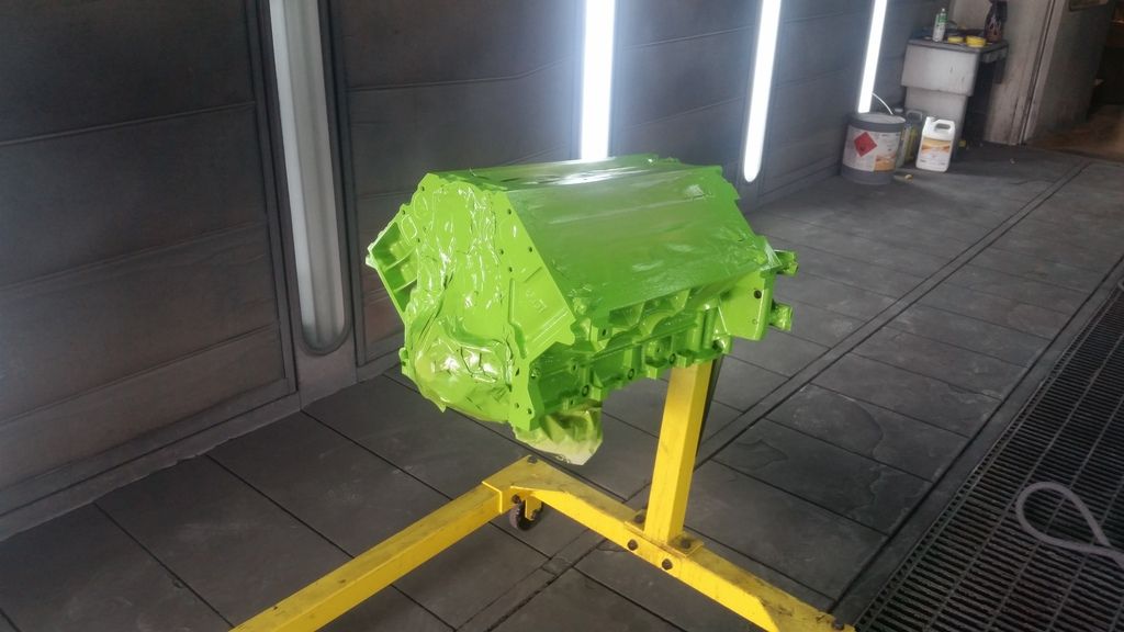

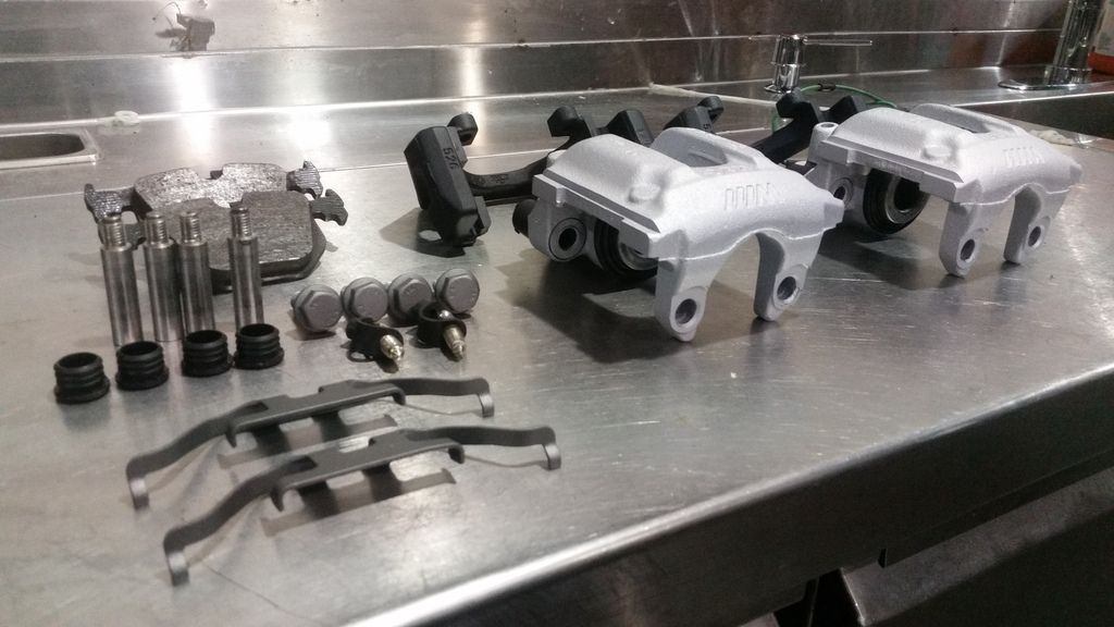

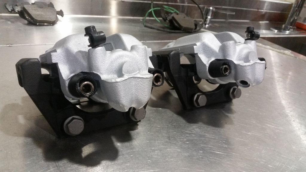

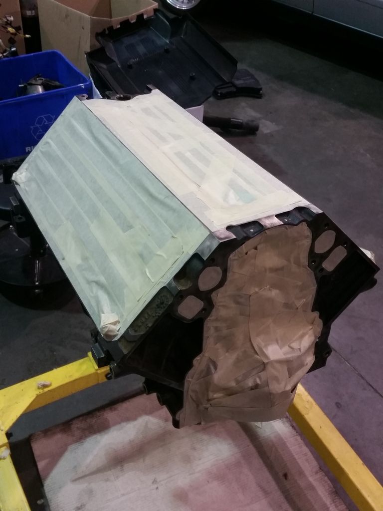

its still a work in progress, the engines not even close to being ready & LOTS of parts are still needed..... heres the progress so far
2004 325CI 5 speed

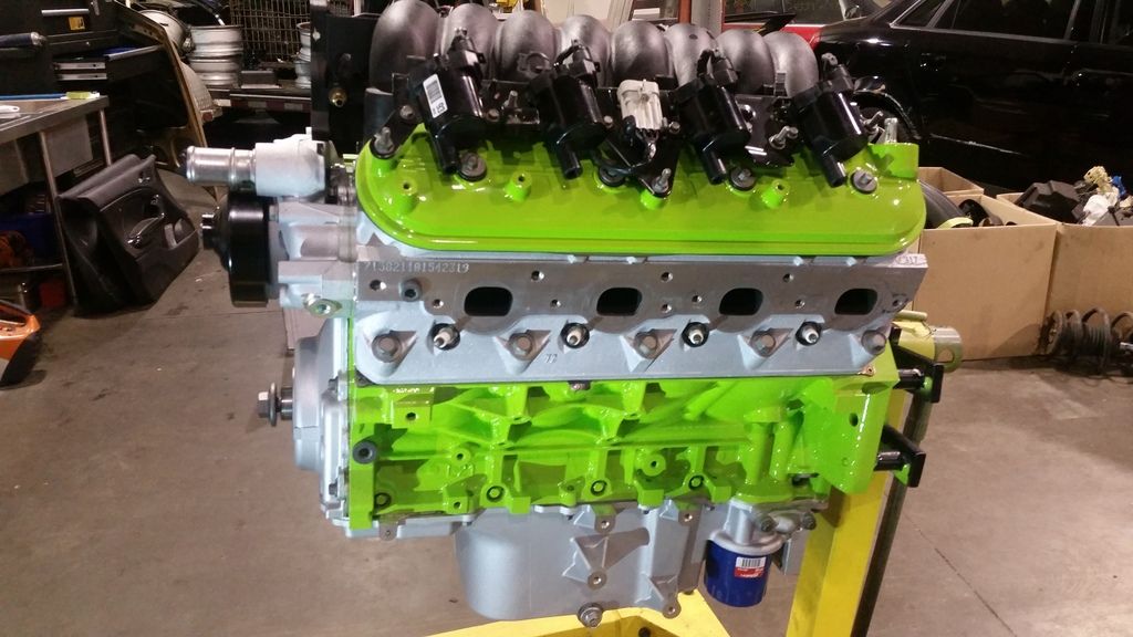

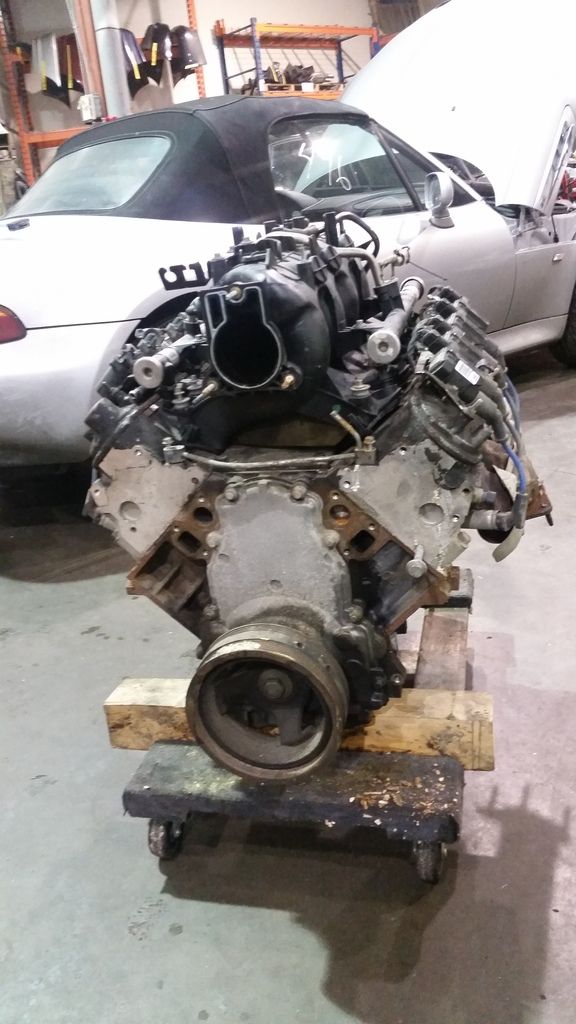

and this beast!!! 6.0L of GMC work van goodness, its a 2006 LQ4 looks so good you could almost drop it in just like this......

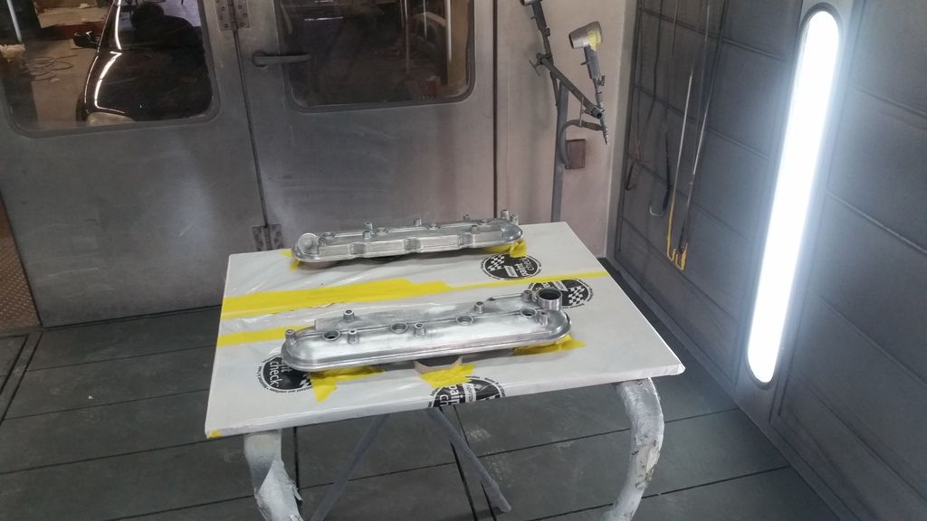

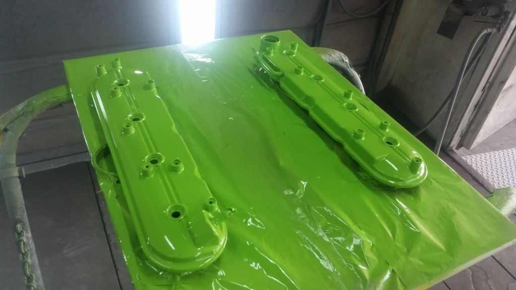

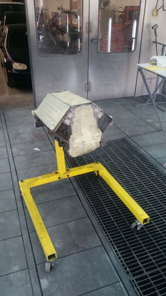

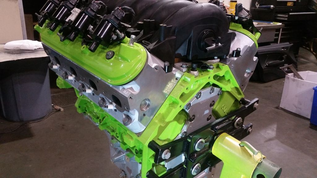

but didn't stay that way for long
the color gets mixed reviews.....

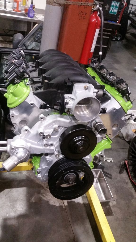

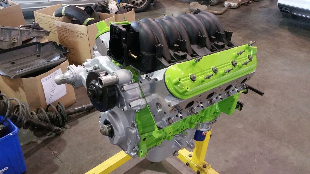

heres the LS clone all cleaned up, still getting pieces together... LSA water pump, LS6 intake, LS3 oil pan

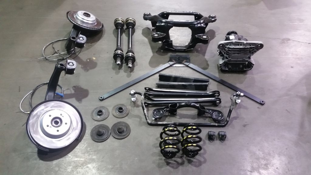

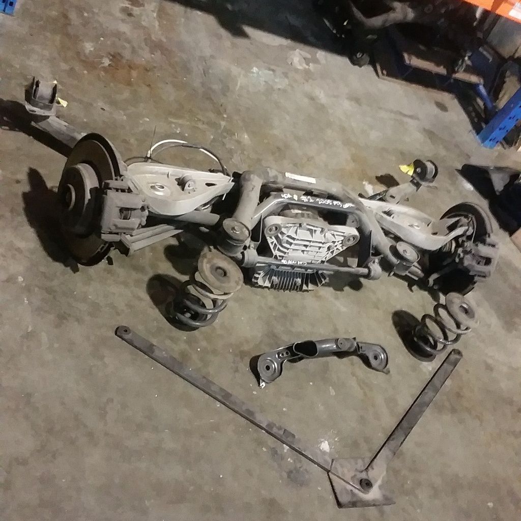

the car is also getting a complete rear subframe assembly from a 2005 M3 coupe
theres going to be a ridiculous amount of care and attention in this build

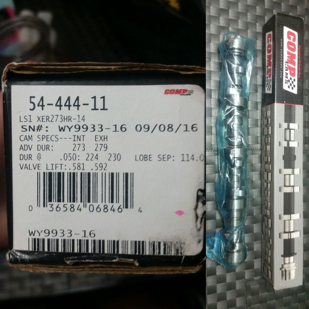

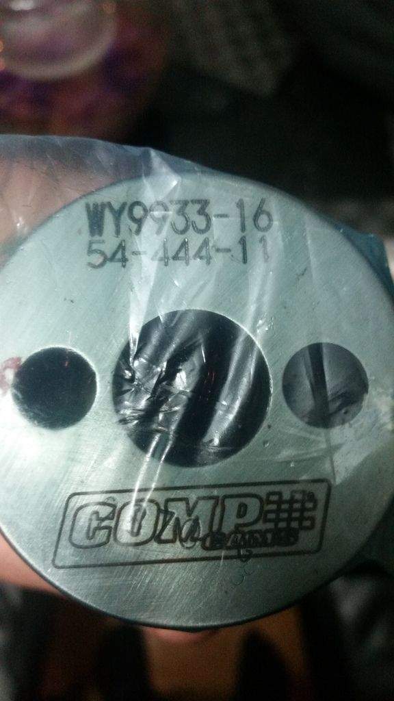

a modest street cam will keep this engine more than interesting

Questions:
1. What will the car be used for? Road, track, drift?
2. Why did you go for the M3 rear end? for its LSD?
3. What swap kit are you getting? or doing custom fabrication for mounts?
6 Posts
Discussion Starter #17
Questions:
after the swap, the car will be a nice weather driver only, just a mild street car
i used the M3 diff for its size and yes because its a LSD as well
i will be using either CX racing or Vorslaq for the mounts headers etc...
