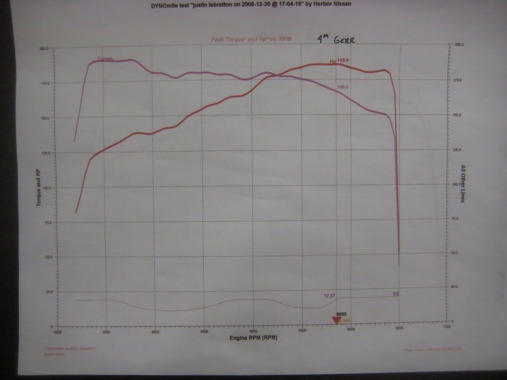

How this will work:
Member name
Car/Engine
Mods (brand of each mod you want
Dyno type
Peak numbers
Graph
I'll go first
Car/Engine: E36/7 M52tuB25
Mods: Custom tube type CAI
Peak numbers: 185whp/19Xwtq
Dyno type: more than likely a bullshit dyno.
Mods: Custom tube type CAI, thermal wrapped Ebay headers
Peak numbers: 210whp/217wtq
Car/Engine: E46 M52tuB28
Mods: Short ram intake, Thermal wrapped headers, Resonator removal
Peak numbers: 180whp/189wtq
Dyno type: Dynojet
(dyno is vs stock headers)
Car/Engine: E46 M54B30
Mods:Sreamline filter, EvoSport pulleys, Shark Injector, Technik Gen3 headers w/ Swain coating, Magnaflow full catback
Peak numbers: 220whp/216wtq
Dyno type: Dynojet
