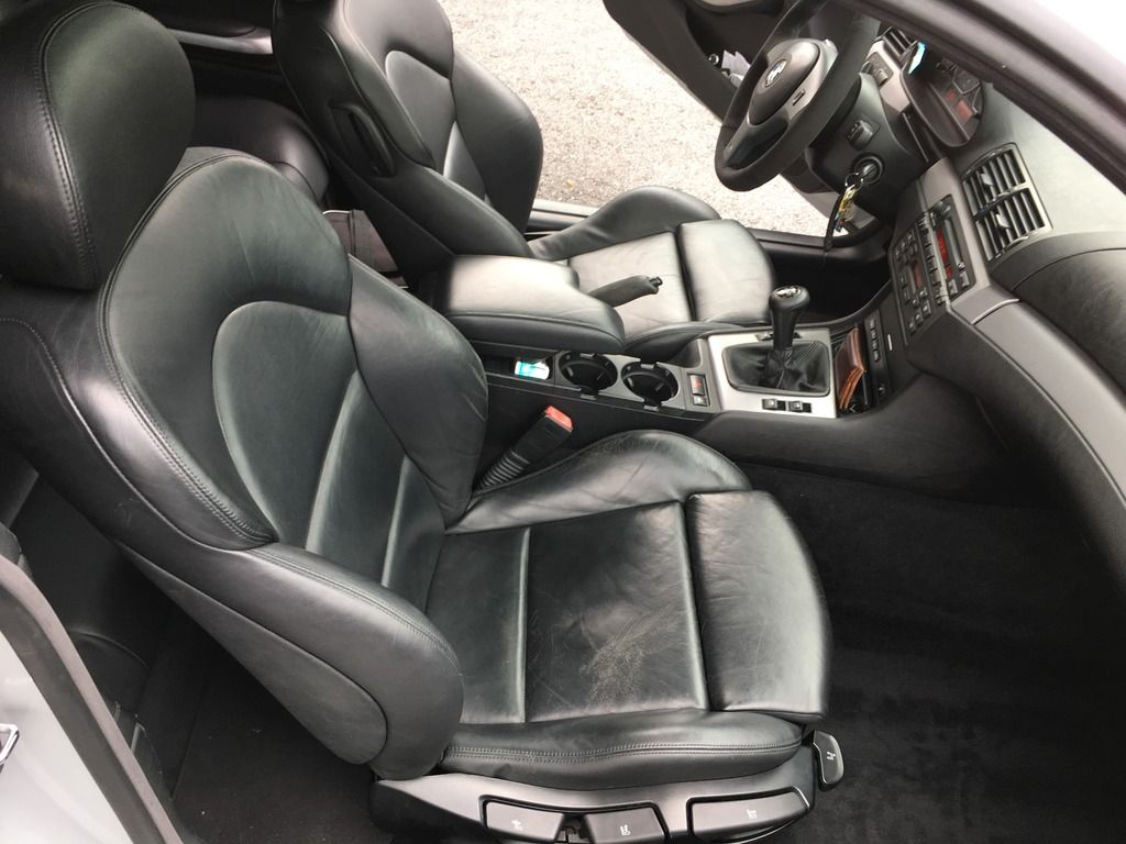

Hey all, I've been trying to research swapping the leather from one front seat to the other, and couldn't find anything promising. I've had my M3 for a little bit now, and with 100k miles, and several previous owners the front driver's seat is quite worn. Thankfully there are no tears in the leather, but there are some faded areas, scratches, and the cushioning is worn thin in the normal spots.
I've recently undergone this DIY with no prior guide, in hopes of good results, and its turned out to be a success. With the leather off, it was cleaned and re-conditioned. The passenger seat leather was near perfect and the cushioning was firm, so it all was a no brainer. For those who don't want to buy aftermarket seats, just yet, dive into this! Just restored my driver's seat to perfection.

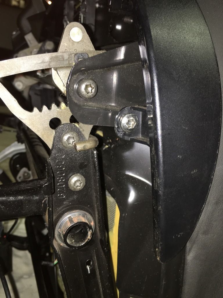

Each seat has two plastic covers, at the sill, remove those to reach the bolts that secure the seat to the floor. Remove the two front nuts, and rear bolts with the 16mm. Remove the seats at a normal 90 degree position.

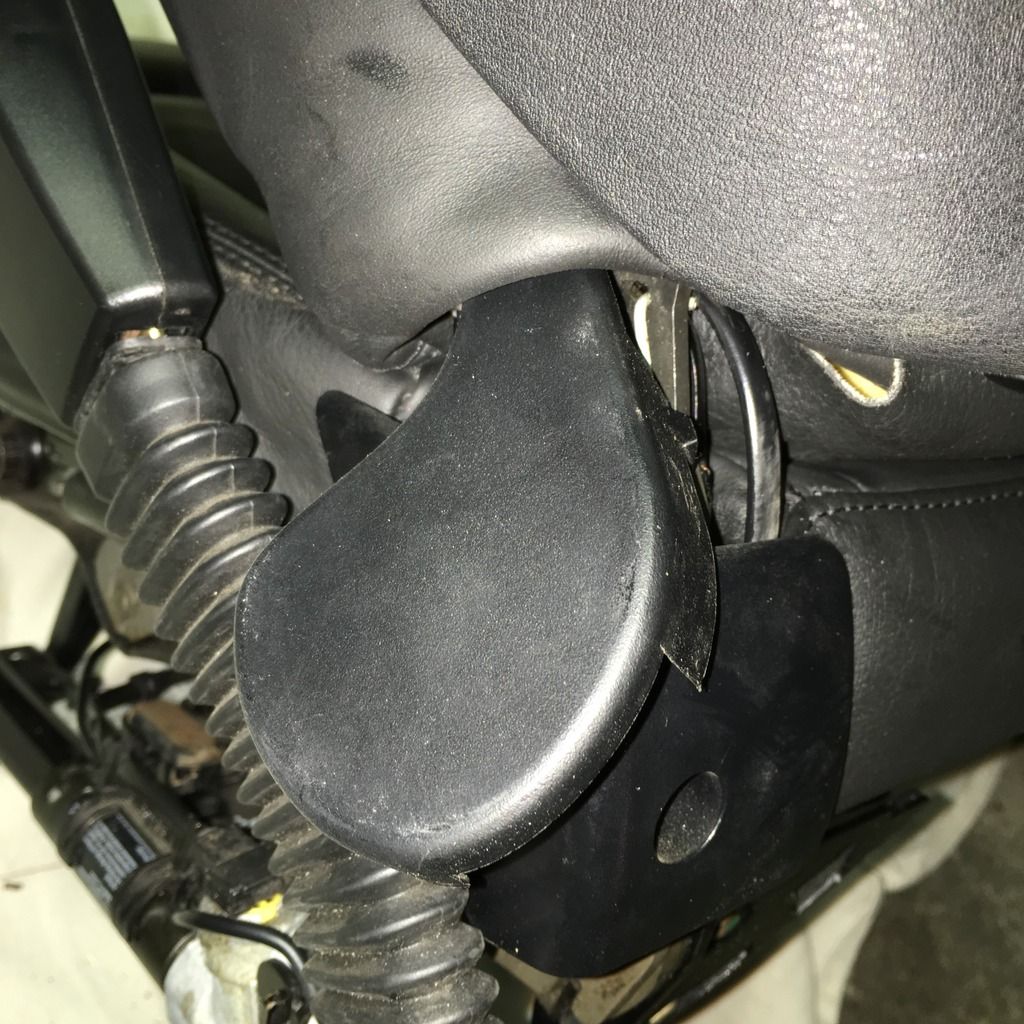

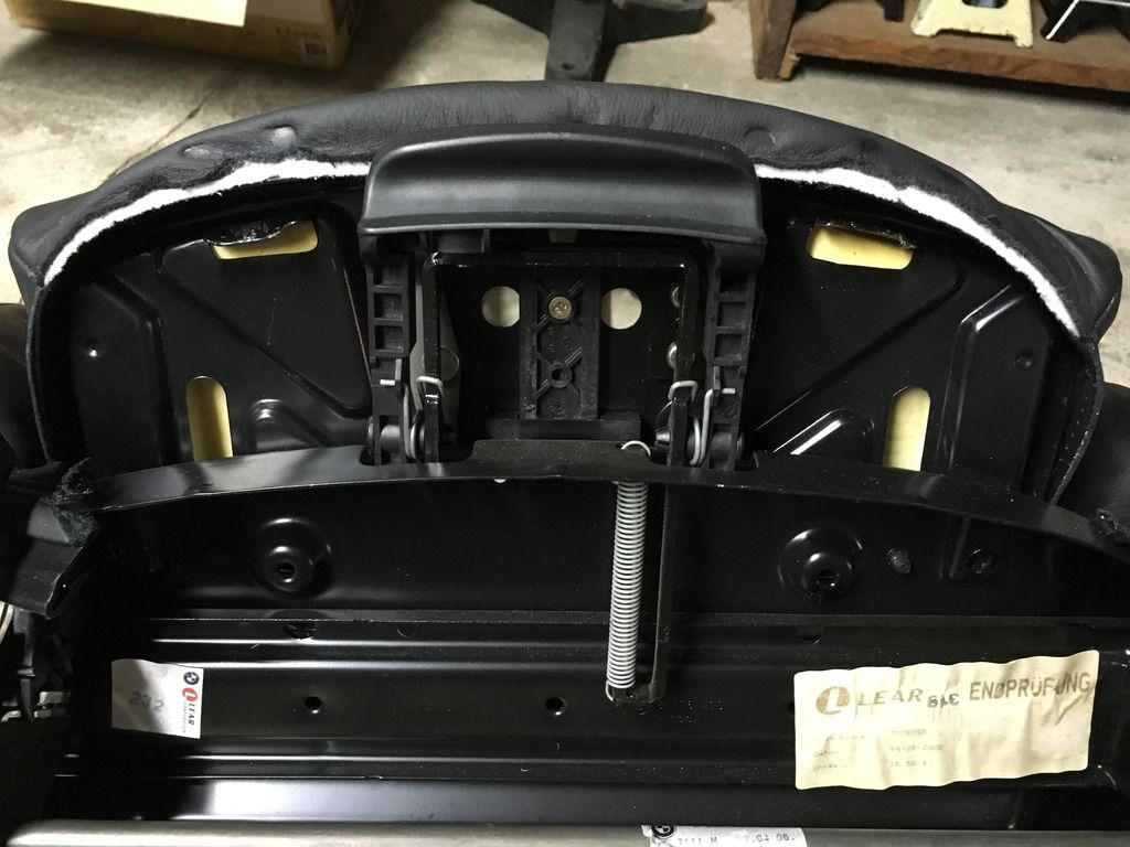

Remove the two plastic covers at the rear of the seat where the upper body meet the lower base.

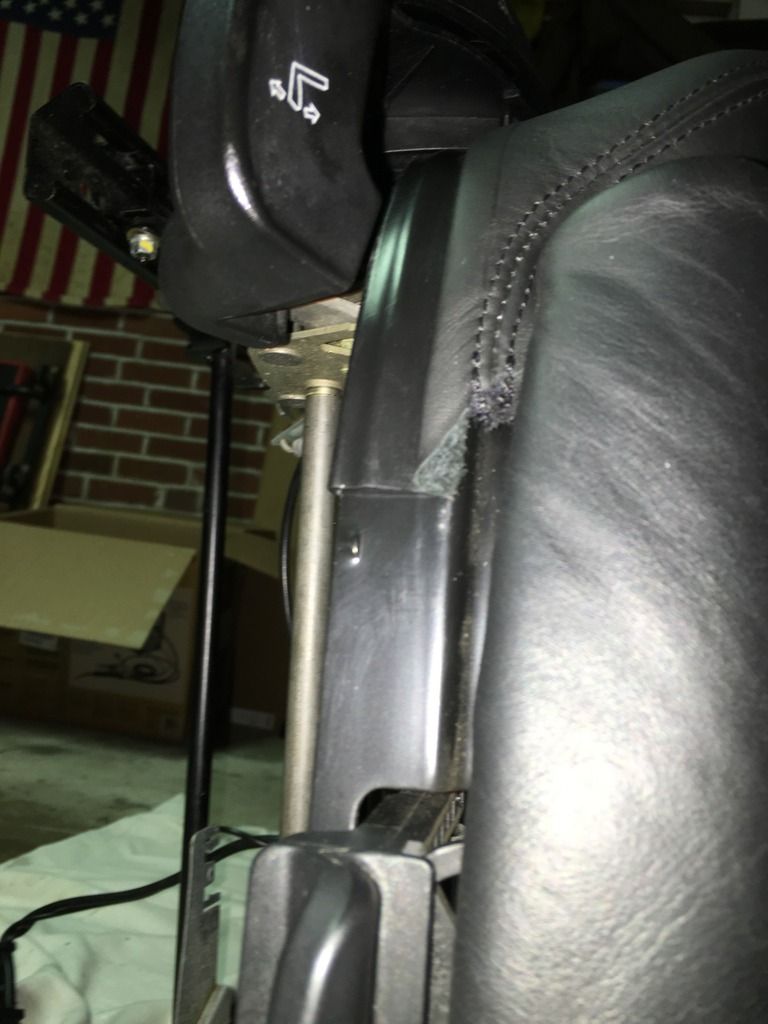

Remove the two plastic covers that hide the hinge of the upper/lower. Take a slight tug outward left or right, the a hard wiggle downward towards the bottom of the seat.

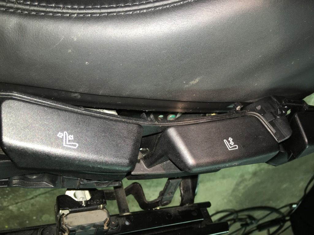

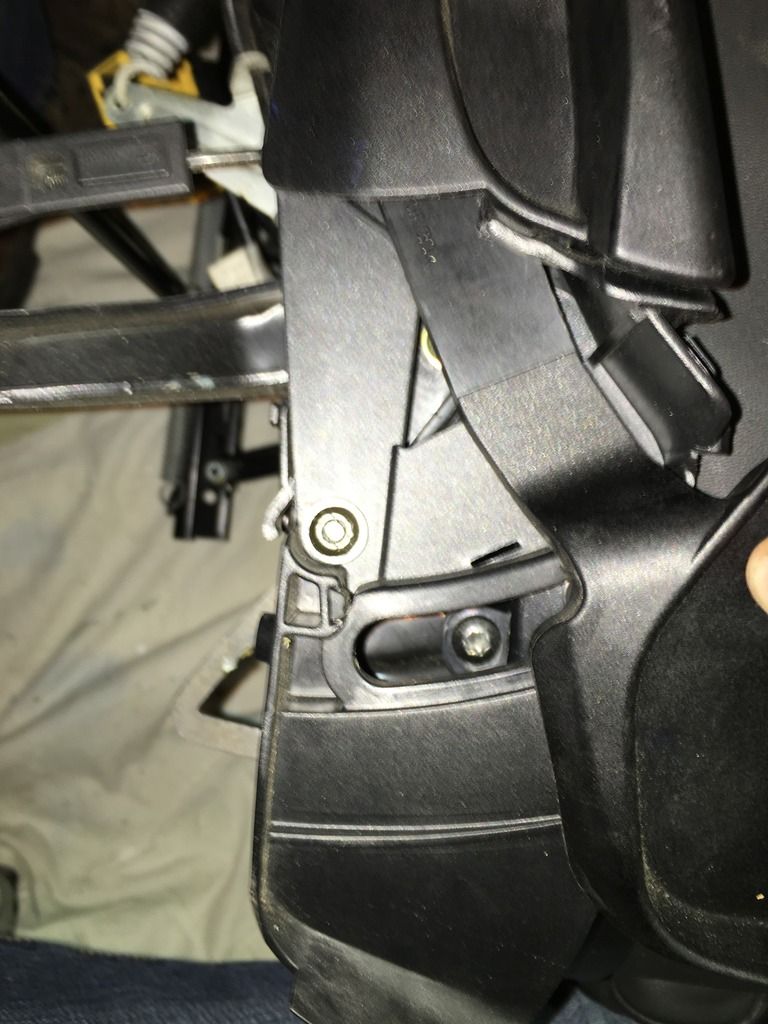

The cover over the seat controls needs to be removed. It has three main tabs which you need to find underneath, pry with your finger. Once released, you can run your fingers along the border and release the mini tabs that pop out of the controls.

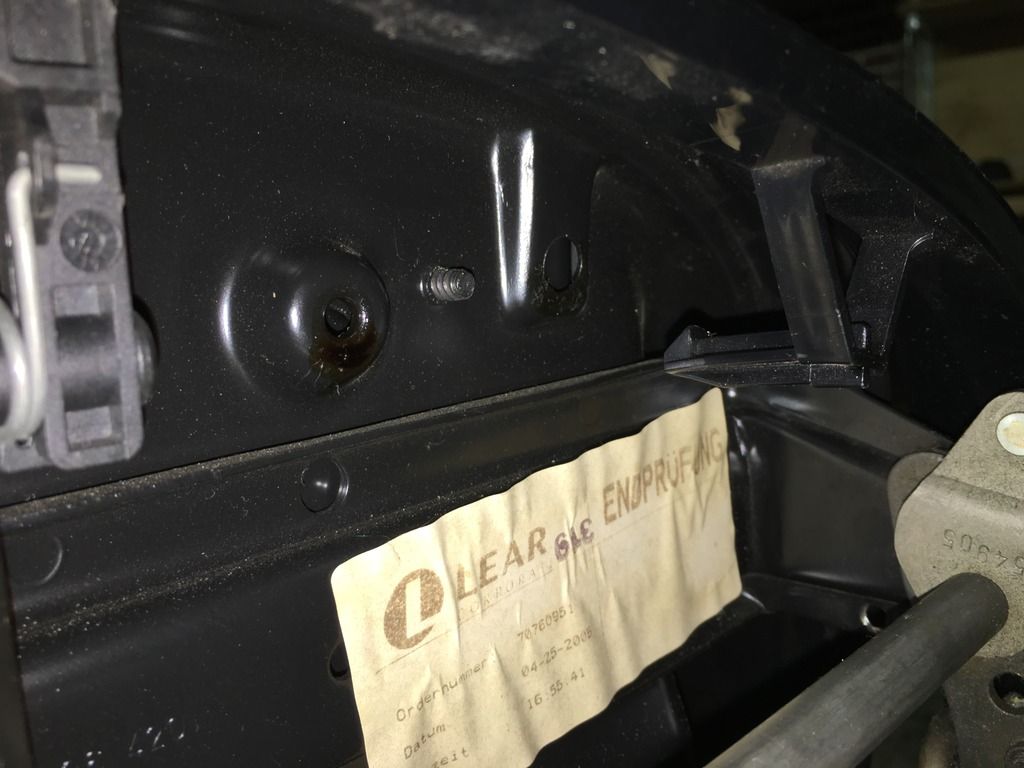

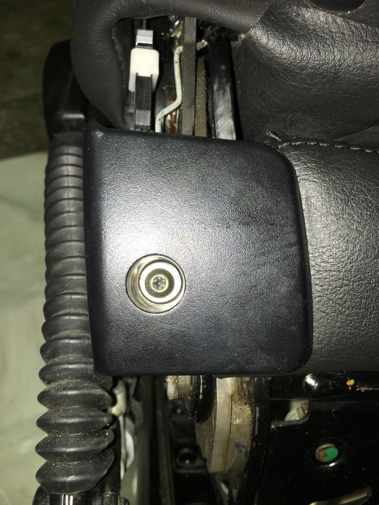

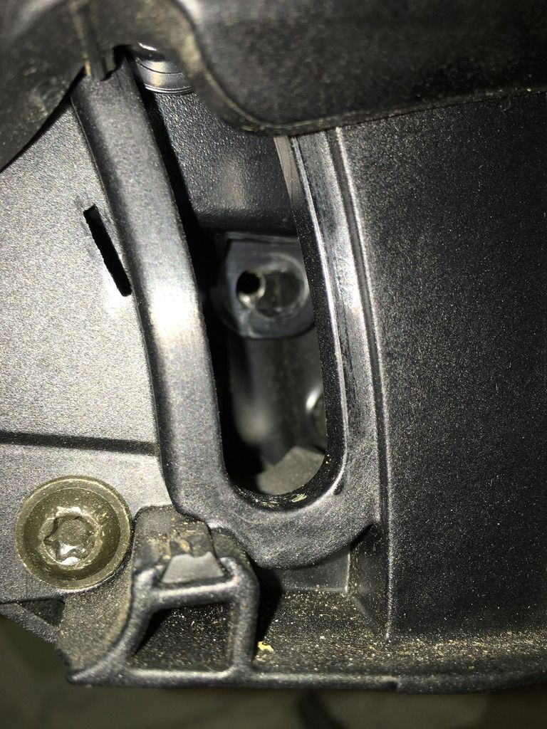

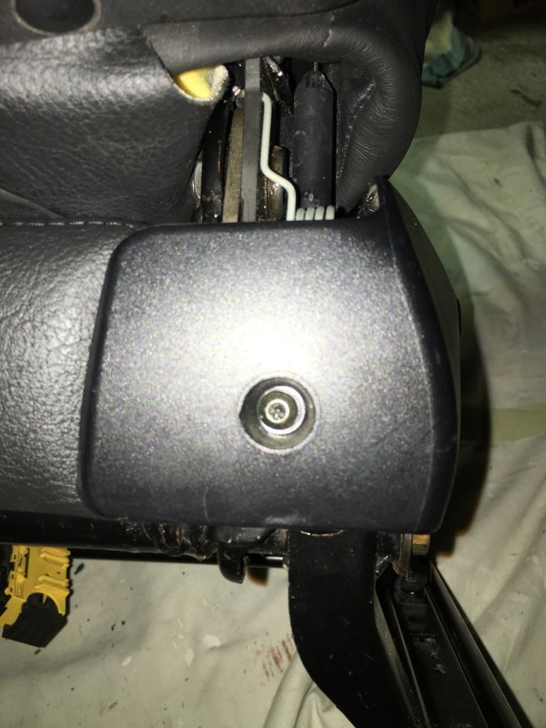

The next part is tricky, IF, you don't have a torx screw driver! There is a plastic cover just underneath the front seat thigh cushion lever. There are two screws, one on each side. The one screw at the seat controls, is behind the controls. I did this without taking the controls off, saved headache; I didn't have a screwdriver, only a torx socket.

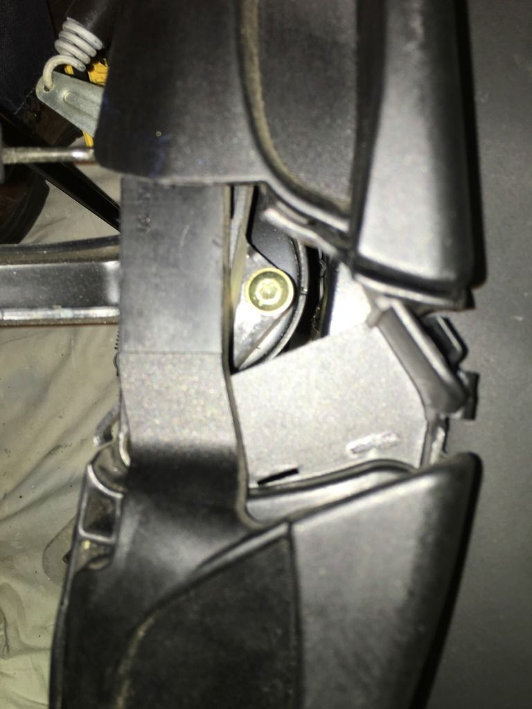

The main screw you need to get to is behind the first control lever. To loosen the controls, find the two screws right next to the main screw, holding in the control unit. You only need to loosen these two screws, which will allow you space to get to the main screw. (Again, if you have a torx screwdriver, skip all this.)
With the controls loose you can squeeze a torx socket underneath the controls, connect a socket extension through the lever slot, and unscrew! Tricky and unnecessary, wish I had a screwdriver. The main screw on the opposite side is very easy to access.
There are two pegs that lock the cover to the metal base, wiggle the cover free.

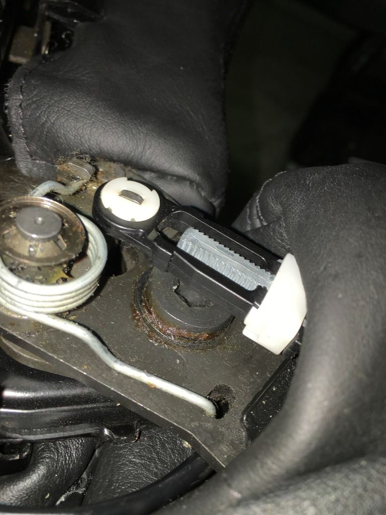

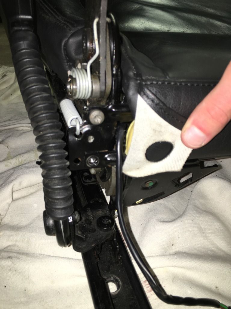

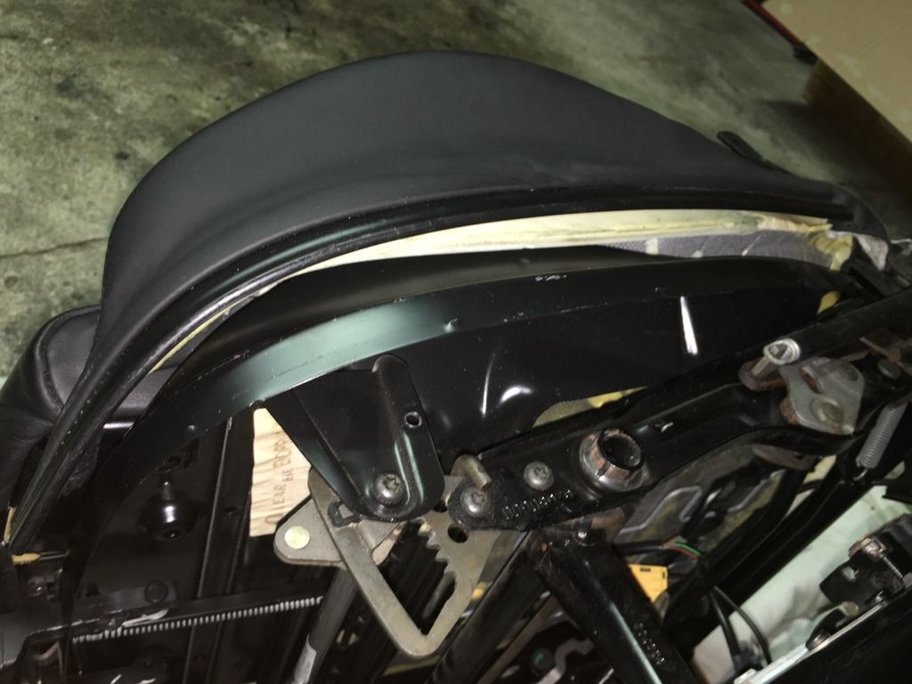

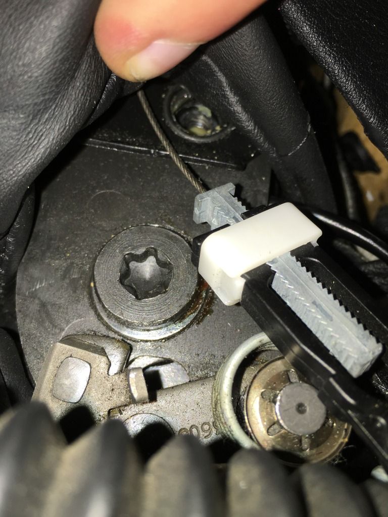

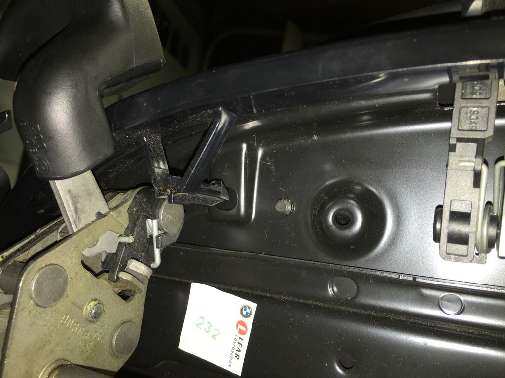

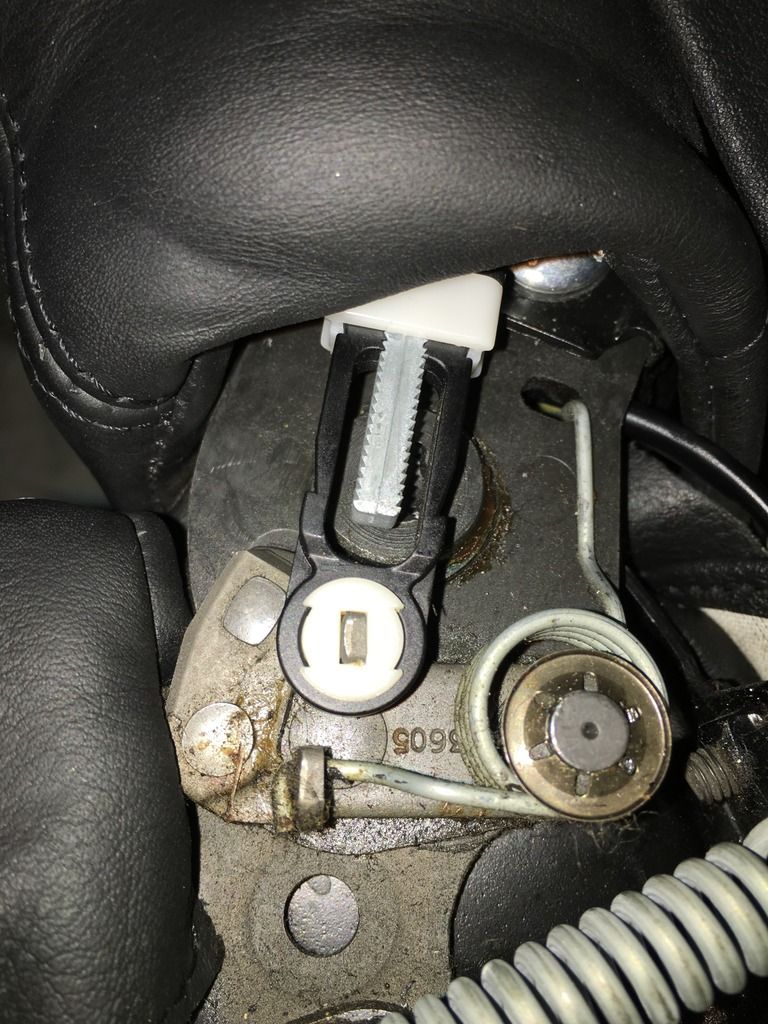

At the seat hinge, remove the release cable x2; flat head screwdriver to pry.

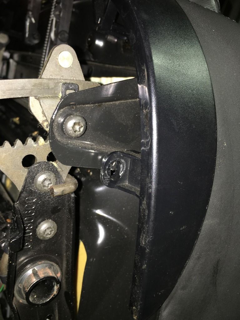

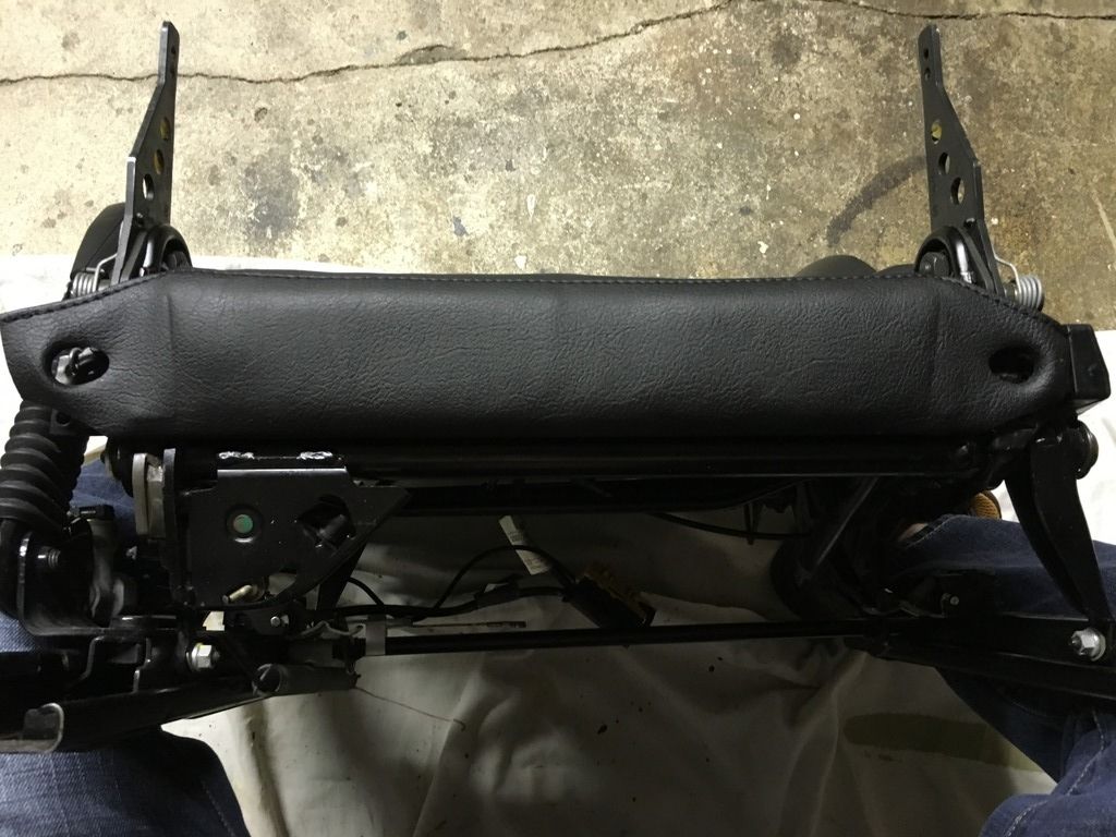

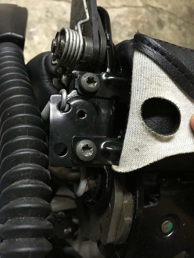

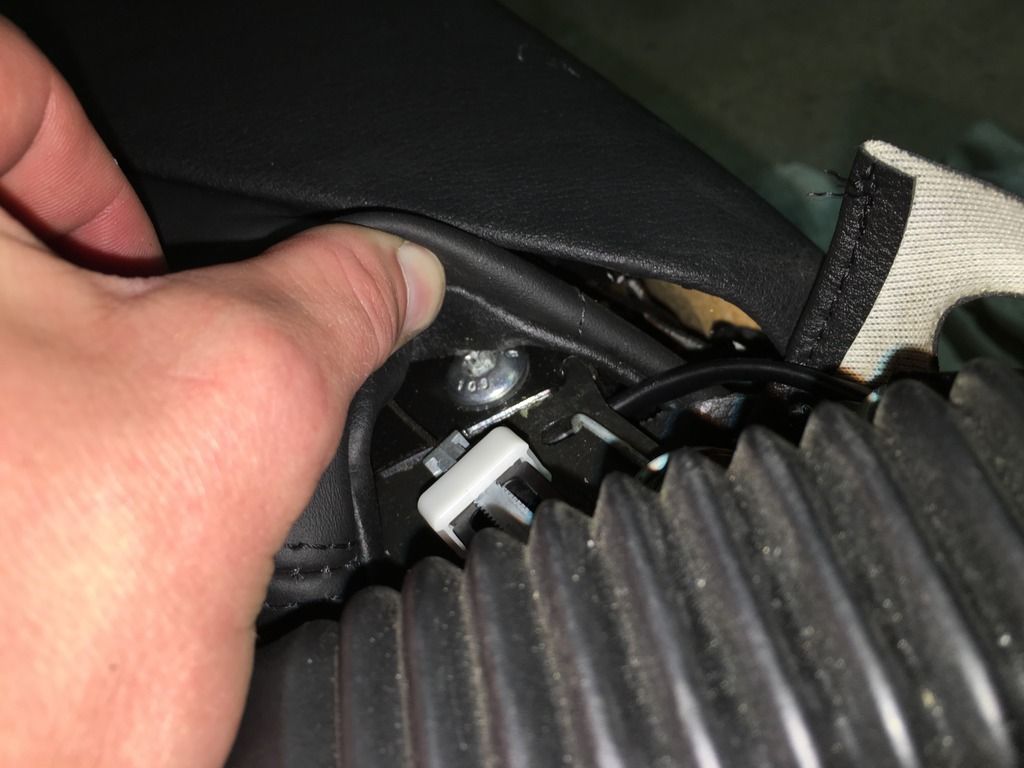

There is a screw behind the upper leather just above the release cable bracket. Stretch the leather back and remove both from each side.

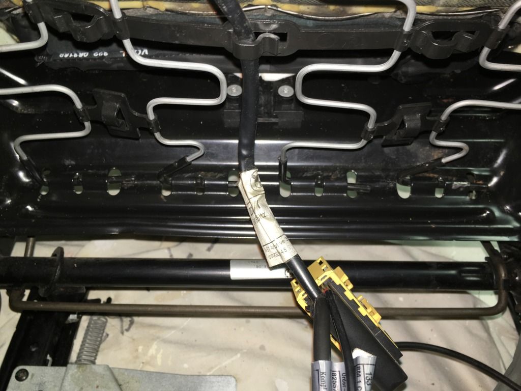

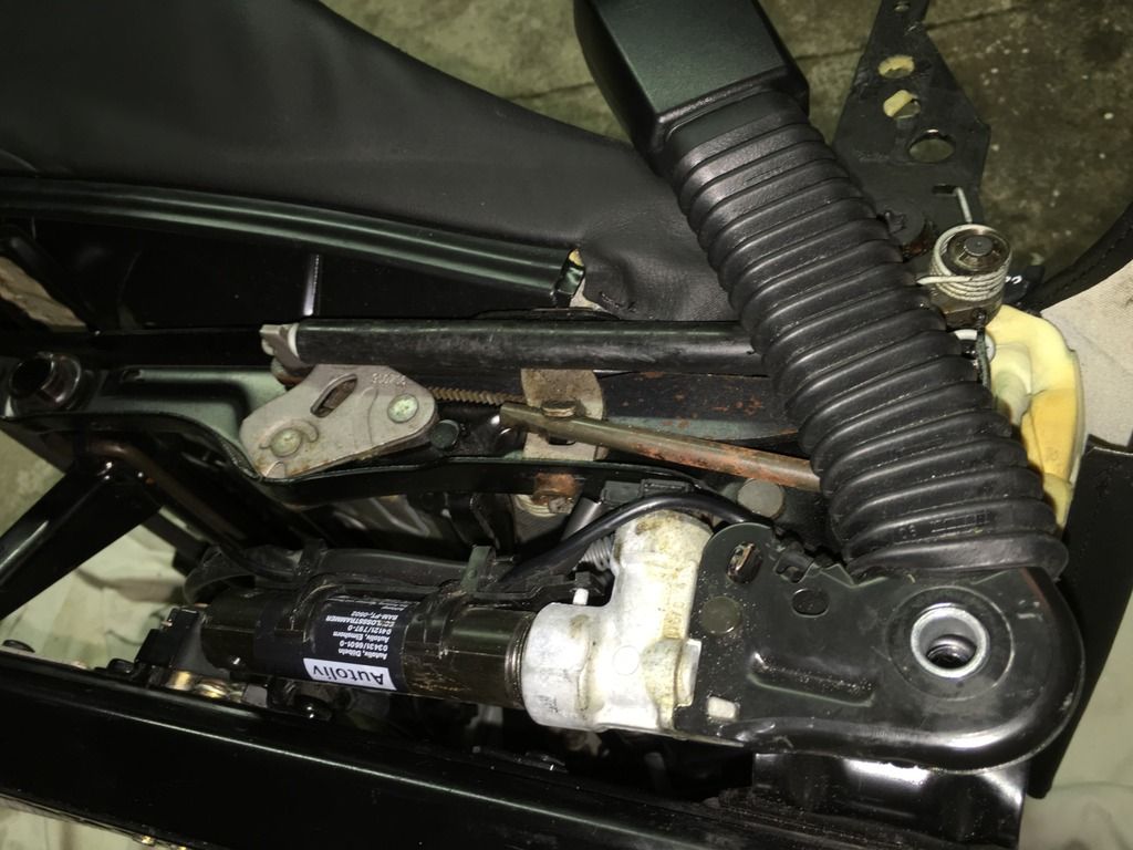

***Before continuing! Disconnect the seat heating wiring. Underneath the seat, disconnect the brown/green wire connectors. This is connects the main control unit to the upper and lower seat heaters. Cut the zip ties holding ALL the wiring underneath. Fish the upper body heating wire towards the back. My fault was forgetting this step, ripping the heating wires in half, requiring me to solder them back together. I didn't take a dedicated picture of this, remember remove these wires before you separate the upper body from the lower.
· Registered
13 Posts
Discussion Starter · #4 ·

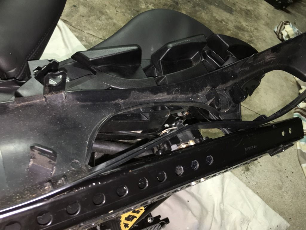

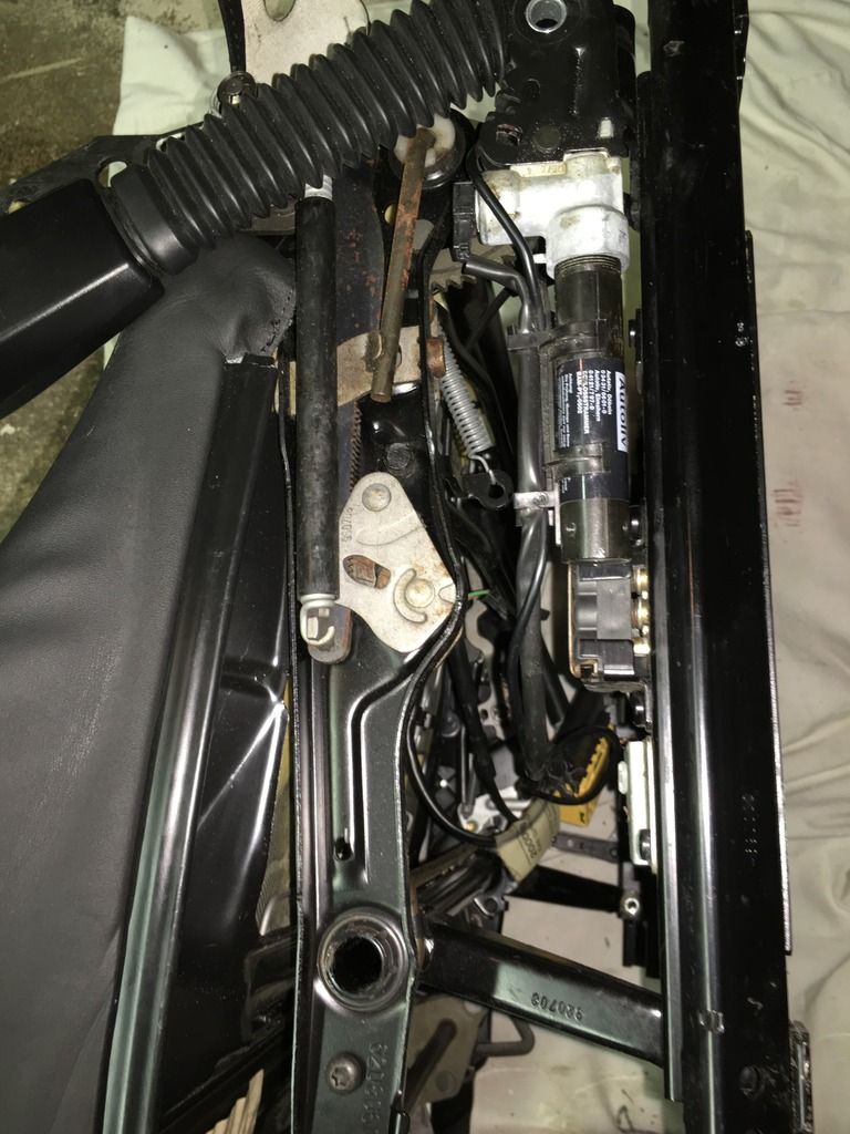

Tug hard on the upper body to remove from the base, carefully fishing the heating wires through the base. Next, remove the four screws to the rear bracket of the lower seat.

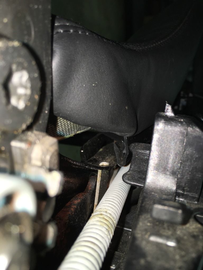

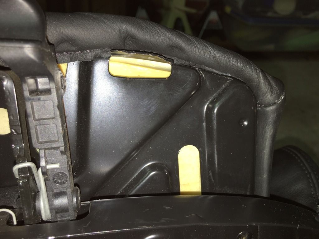

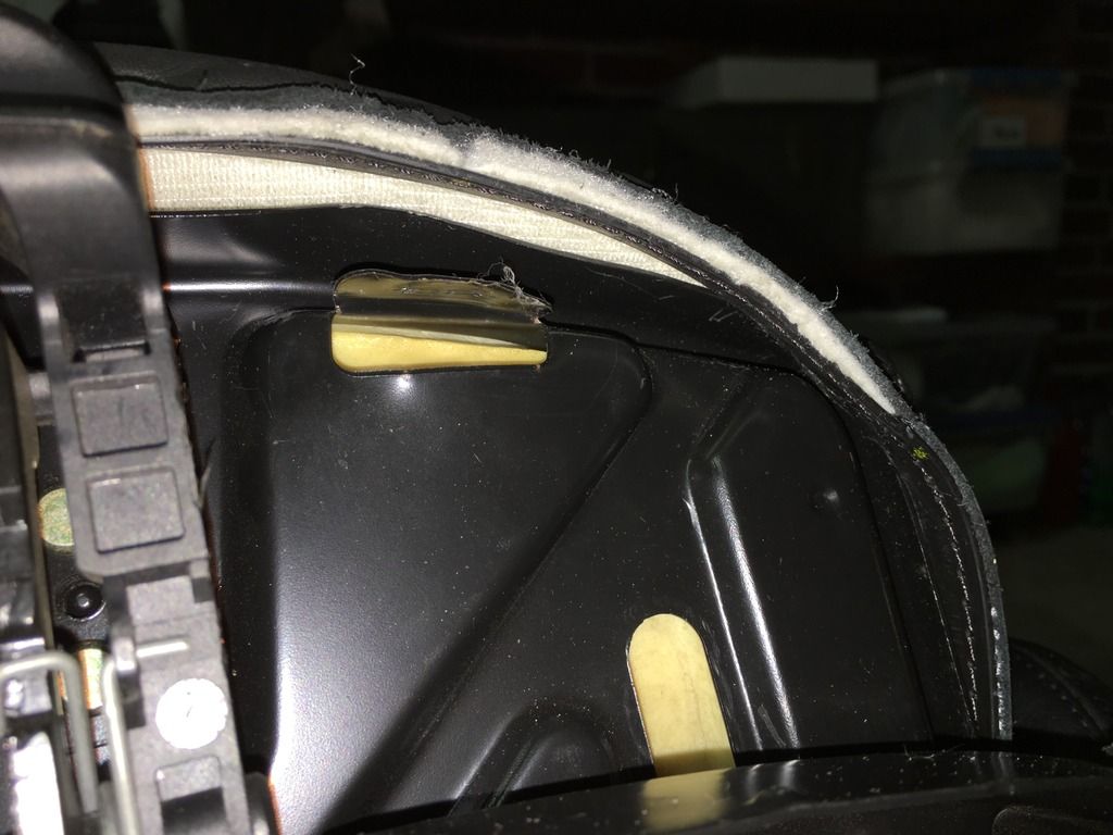

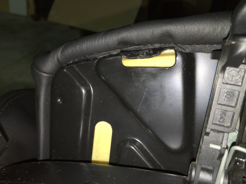

Next is to remove the leather bolsters, secured to the base by a long plastic clasp. Remove the side opposite the controls first. Either work the leather bolster downward, and pull the plastic clasp of the metal. Or use a pick to work the clasp off.
The control side is a bit harder. Start at the front first control pulling the clasp off. Do the same to the back part.
Either work a curved pick to release the middle part. Or use the extra slack you have from the opposite released side, to aggressively push the bolster downward.
Remove the seat spring from the front and rear, just pulling the prongs out.

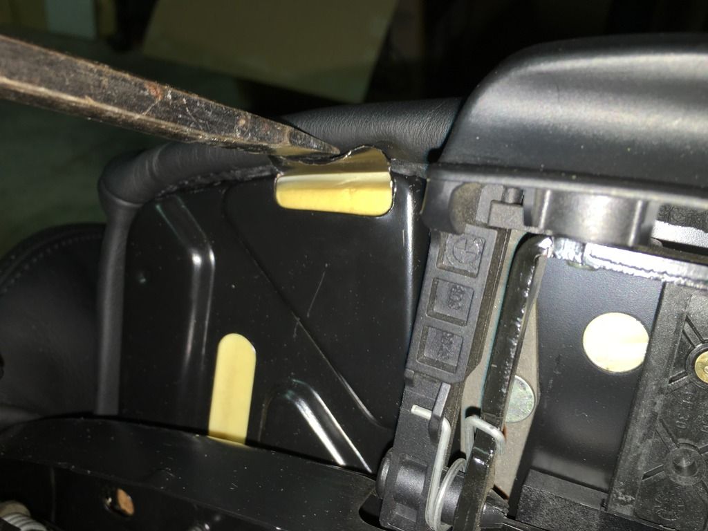

Last part of the leather is the front thigh support. Pry the two metal wings, away from the leather.
From the middle lever, work the flat head underneath the leather, releasing the plastic piping. (*Re-assembly flip the corners in first, then push the rest of the tubing in place)

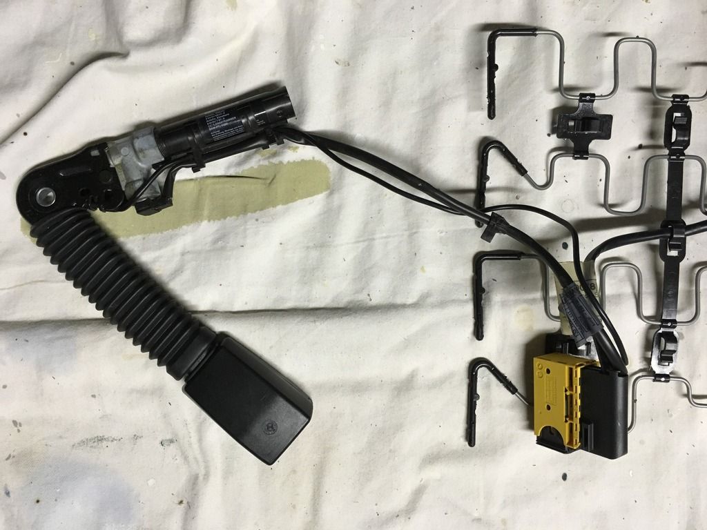

Last, the selt belts need to be swapped.

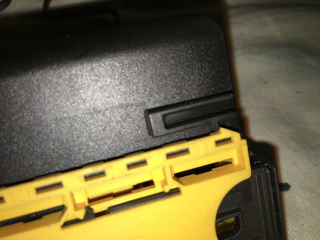

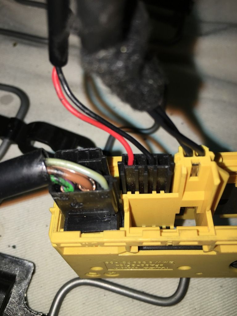

At the main wire loom connector, press at the tabs to slide the black cover off.
Remove the wires to the seat belt. Connector with the red/black wires just pulls out. When removing the second set, mark the two black/black wires "left & right" so you know which position they go on the opposite connector.

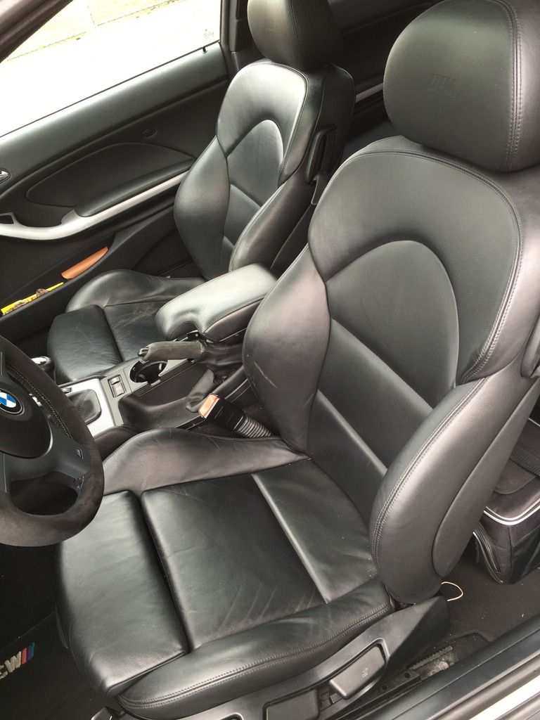

I've driven over 1,000 miles with the new seats already. Nothing but smiles from the driver is all I can say. The driver seat is once again firm and supportive, and the leather has been restored and looks gorgeous.

It appears the only piece holding the top section to the lower section is where you said "There is a screw behind the upper leather just above the release cable bracket. Stretch the leather back and remove both from each side." Why do we have to remove the leather if we want to swap the base as one piece? Or do we not have to actually remove the leather and can just unbolt?
