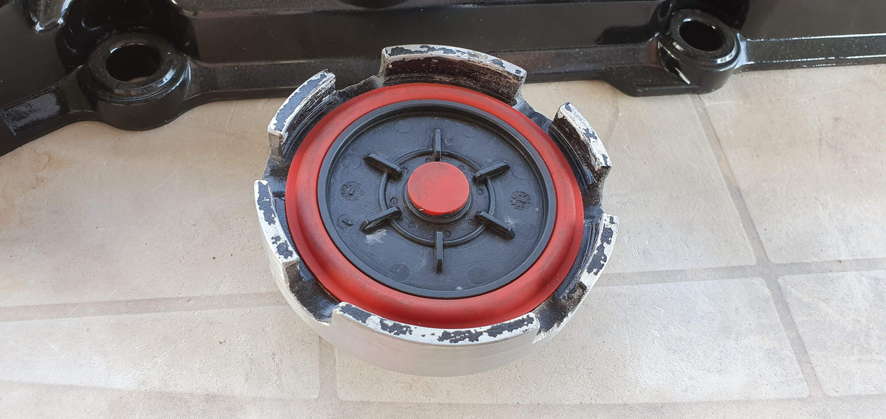

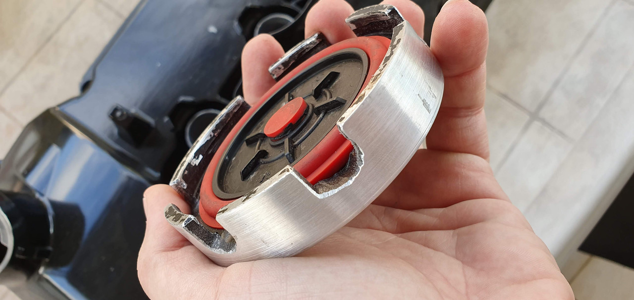

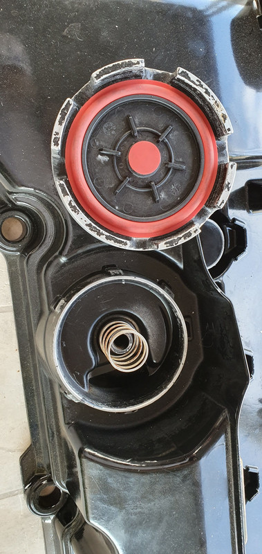

Opening this thread to discuss, present, troubleshoot the aftermarket M56 caps that some members have produced, including my aluminum version. This is to also avoid getting lost in the M56 main thread, so lets keep this more oriented towards the caps :)

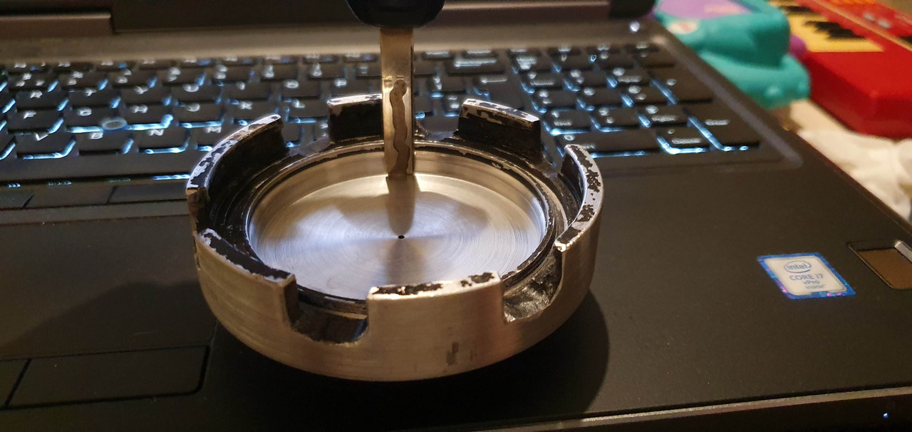

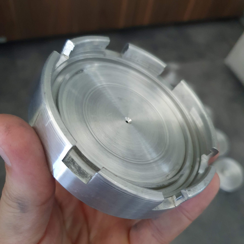

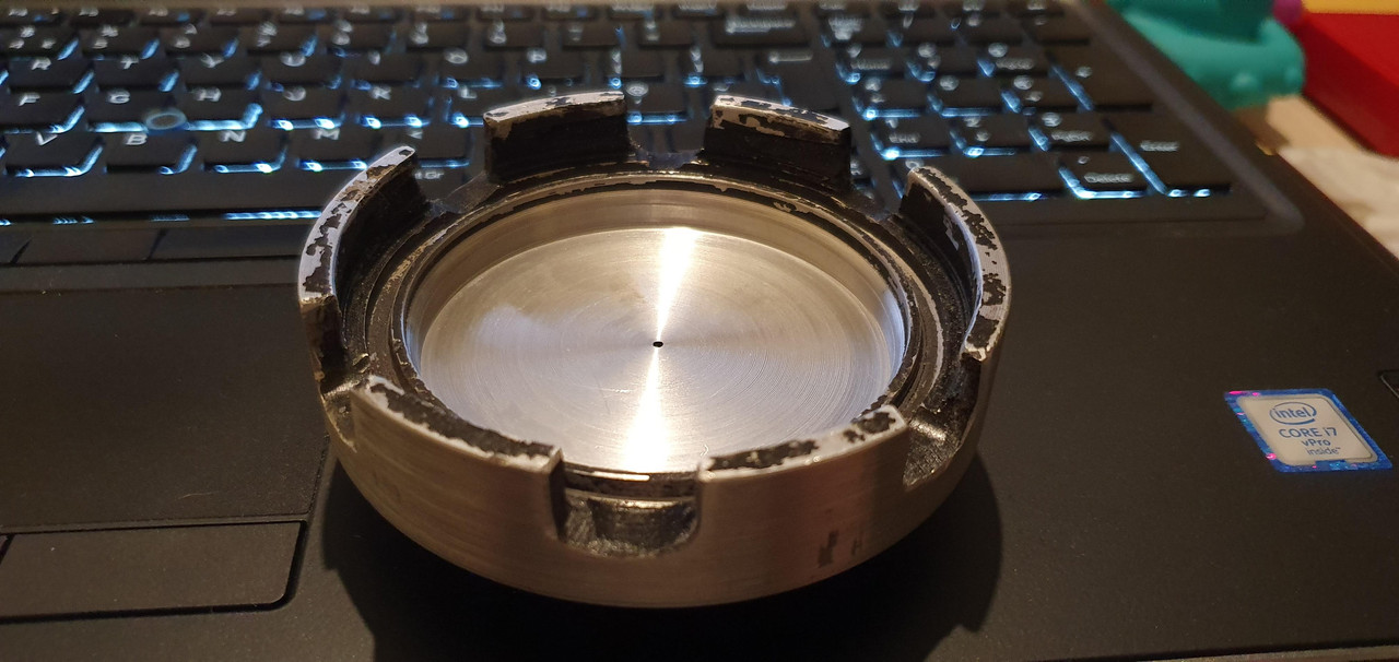

The aluminum cap as of today has been revised by machining the ceiling surface to allow more modulation of the aftermarket membrane (around 8-9mm) and to also allow it to sit higher in order not to seal the valve cover, causing pressure buildup. Before anything, is there a way to test this on a bench? My car is not stock at the moment and I really don't want to swap covers again!
Pics:
Machining has been increased:
https://youtu.be/O_k81QUbfQs
Original:
Original design/pics:

The machining does allow proper modulation with the russian membrane. As I am not running the stock system anymore, I can ship (on my expense) my prototype cap to anyone that was in the original group by to fully test it, if everything works, we can organize a return back for massive correction. Thoughts?

I dropped the valve cover (again) to the machinist, with the russian membrane this time and the aluminum caps (mine and one of the batch order) for re-machining. The objective is to allow a modulation of around 6-7mm with the russian membrane installed. ... I also have an idea, to machine a thread on the top cap (wrench section) to allow someone to install a screw cap and an o-ring in case the cap is going to be used membrane-less.

I just picked it up from the post office.
Swapped mine out and checked vacuum at oil fill cap.
Idle test is good, will do more aggressive testing soon.
Thank you, paraklas
My continued thanks go out to omgwtf and paraklas! Looks like from the omgwtf videos the modifications are certainly promising. Great work! Let's all keep our fingers crossed that the long term tests go as well! Thanks again!
