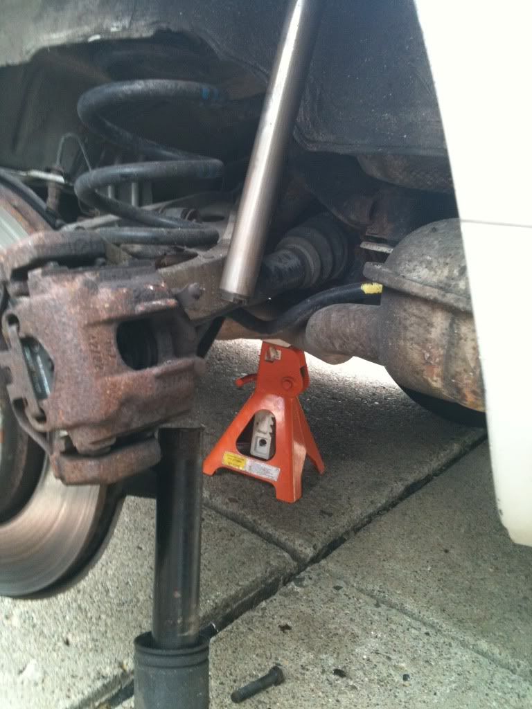

I was experiencing the "bump hop" or whatever it is described as, along with some inside tire wear, and also when I spun my tires around turns the rear was making a thumping noise like the tires were skipping. I decided to order RTABs and give it a go.
They arrived today and I jacked the drivers side car up removed the tire and noticed that the shock was overextended. I disconnected the bottom bolt and "plop" the shock fell apart. Looking around at this mess I also noticed that the spring was busted. I decided to say screw the RTABs right now as I have bigger issues. I did not hear any type of clunking or rattling before doing this but after getting upset uncovering this :censor: i put it back together and now its rattles like a :censor: :censor:

Sorry to hear what you found man!
A) Great time for H&R Springs and Bilstien/Koni shocks
B) Great first post....not newbish
C) I *think* I may still have two sport suspension springs I could send you for cost of shipping...that is if I haven't already thrown them away, I'll have to look into this.
D) The rear springs and shocks are a easy DIY, so that's not too bad of news (besides the obvious cost aspect...then again, at 180K+, who didn't see it coming)

The rears run a stock camber of -2.1...so inner tire wear is to be expected. If it is really extreme though, look to see when the last allignment was done. My personal experience had rears wearing out in around 25K miles.
I'll have to wait until after work to check on those springs, but I'll get back to you either way.
I ran H&R Sport Springs (for E46s with sport supsension, it dropped the front around 0.75" and 0.25" out the back) and Koni STR.T shocks. The shocks were comparable to OE shock in ride quality and such. I mainly picked them due to price point. I bought both off TireRack.

I found a guy about an hour away on craiglist with some used oem springs/shocks off an 01 330CI with 110000 miles for 60 bucks. :woot: I may go this route just to get the spring/shock fixed asap by this weekend and order some H&R springs n Koni STR.R shocks when the funds are available in two weeks.
Would anyone strongly advise otherwise?
Are people going with the H&R springs over stock mainly because of the lowering aspect or because the OEM part is more expensive and/or less dependable? :hmm:

Broken rear springs are actually really common I hear. I'd definitely use it as an excuse to drop the car all around but of course, that means buying 4 springs and shocks, not just 2. It's up to you. Replacement OE springs can be picked up for $59.78/ea (free shipping) @ BMAParts.com. Shocks are pretty cheap there too. I would however definitely pop over to TurnerMotorsport.com and pickup their rear shock tower reinforcement plates for a meagerly $31.95.
