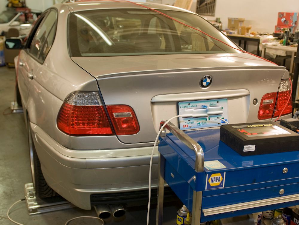

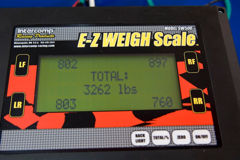

For some reason there is a belief because E46 is bigger that it weighs about 200 pounds more than E36, therefor drag and track racing people tend to look for a E36 project.
Fact is stock to stock E46 weights about the same as E36.
2001 330ci manual
2000 323i manual, no sunroof
These weighs are about the same as 1998 328i E36 and 1999 328is E36

#2 ·
I always thought that people chose the E36 because the OBDI computer is friendlier than the OBDII for racing purposes.
#7 ·
You'd need to weigh the E36 on those same scales to make a valid comparison. You're criticizing published weights of the E46 but using published weights of the E36 to make your point.
Also I'm not sure anyone ever argued the E46 is 200 lbs heavier. Maybe the M3 yeah, but not E36/M vs E46 non-M. I've always said the E46 non-M weighs about 60-80 lbs heavier than an E36 M3 similarly equipped with manuals.
Also that 330 w/ sunroof, possibly heavier wheels, larger brakes, axles, etc. should be more than 40 lbs heavier than a 323 with no sunroof and grandma wheels. Not sure what's going on there.
There are plenty of threads were people weighted there E36, number seems to be around 3200 LB which confirms the fact they weigh the same.

#8 ·
Oh for the record, myth not busted here. The E46 is heavier than the E36. But that's not a knock on the E46. The E46 employs various weight saving materials vs the E36. Considering its larger and sturdier than the E36, the additional weight it does have over the E36 isn't bad at all.

#22 ·
You can't bust a myth without data to bust it. You need to weigh E36s as well. And, although annoying, to be scientific about it your sample size should be larger than one car.

#24 ·
you've not proving that point. you have to show the same equipped E36 on those exact same scales. those scales are for corner balancing, not gross weight. but even so you'd still have to show same equipped models. that sedan has no sunroof, no Xenons, no fogs and no Sport package to name just a few.
interesting photo found but this has not proven what you say it has. sorry
#26 ·
I agree, if you don't actually weigh both gens, similarly optioned, you aren't providing accuracy and thusly your assertion cannot be anything but suspect. One thing specific to e46s I haven't seen anyone post up about yet is that E46s have many more airbags and stereo speakers than e36. These details add weight. And those shop scales could be off. There could be stuff in the trunk. If the cars aren't 100% stock, the aftermarket parts could have different weights. Published weights could not be 100% either. So unless you get thorough about it you can't say for sure. And who really cares anyway.
