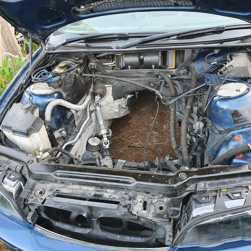

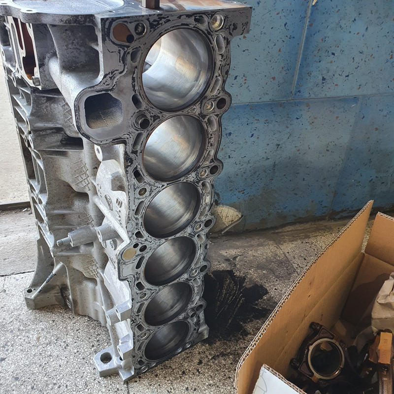

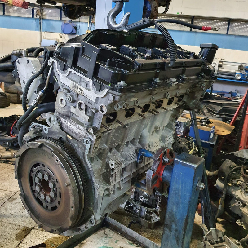

Following up my inexplicable P1345 code, I ended up removing the engine to further investigate. Seems that, I had stuck piston rings on Cyl2 and the rest of the oil ring holes are completely blocked from carbon(?) deposits. Since the engine is out, I also decided to take it a step further by replacing the following (all genuine BMW parts unless mentioned explicitly)
1. Intake/Exhaust/Crank Sensors
2. Crank front/rear seals
3. Crank polishing/balancing
4. ARP conrod bolts
5. Timing chain guides, chain, oil pump chain (pump already reinforced)
6. Motorsport oil pump chain tensioner, ordered from Audi dealership
7. Lower CR pistons from CP, 9.0:1, ceramic coated :evil:
8. Knock sensors, coolant lines, whatever is below inlet manifold
9. New wiring loom
10. Port/polish of head
11. New valve seals
12. Stock 0.7mm or 1.0mm headgasket (depending on machinework)
13. Block timeserting
14. Starter refurbishment
15. Aluminum pulleys (stock diameter) for WP, PS
16. Rebuilt alternator
17. S54 Oil filter housing
18. 68mm supercharger pulley (around 15PSI)
19. Provision for meth injection
20. Port matching ESS inlet manifold with head
21. Port matching exhaust manifold with M-S54 headers
22. Gaskets, o-rings, bolts, nuts, etc
Pics to confirm the project already started :)

The head bolts are one-use and I plan to get genuine bolts. The issue is when overheated, the aluminum block tends to get softer and the bolts cannot hold the correct torque anymore. This is alleviated using timeserts.
In my case, even if the engine never overheated, the block is perfectly flat, it will get timeserted for the added piece of mind.
