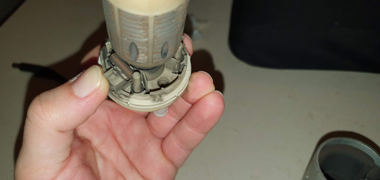

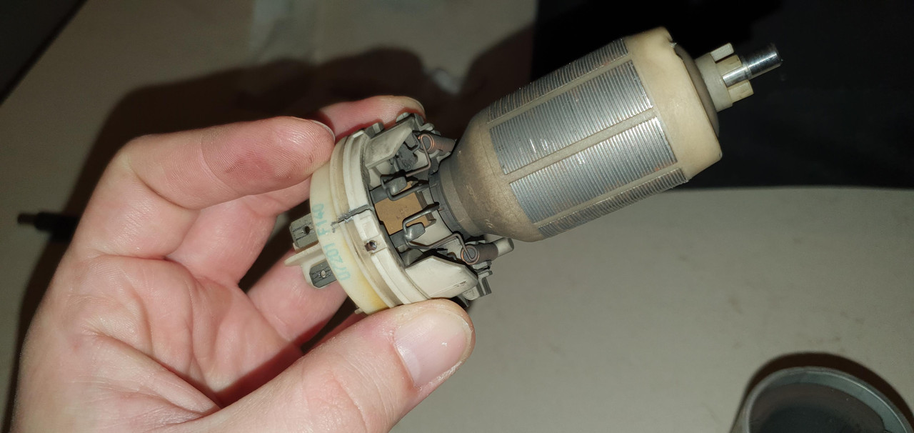

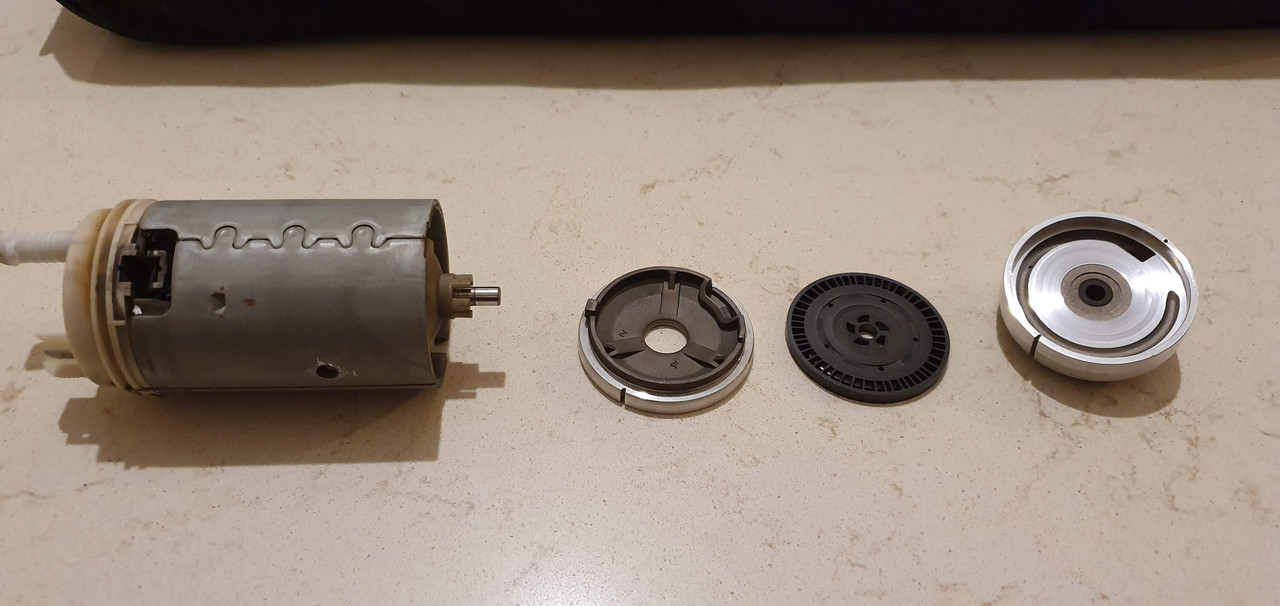

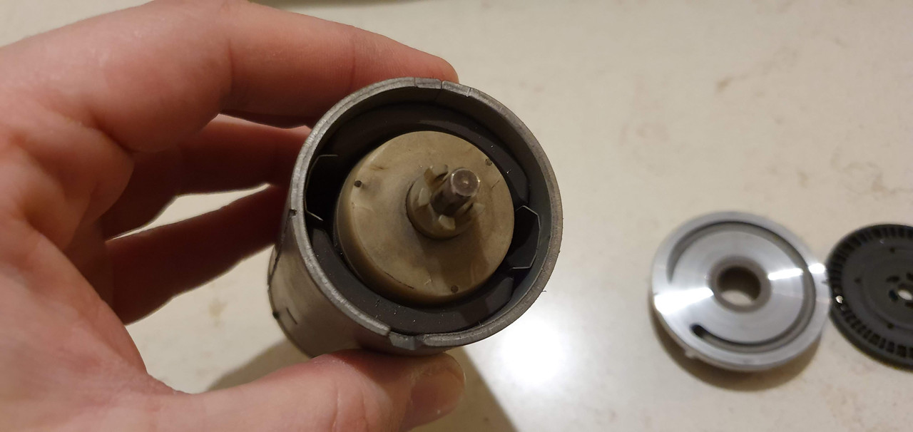

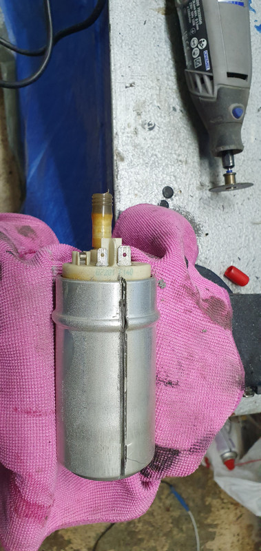

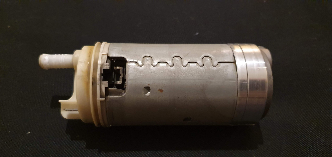

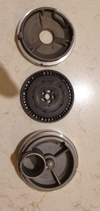

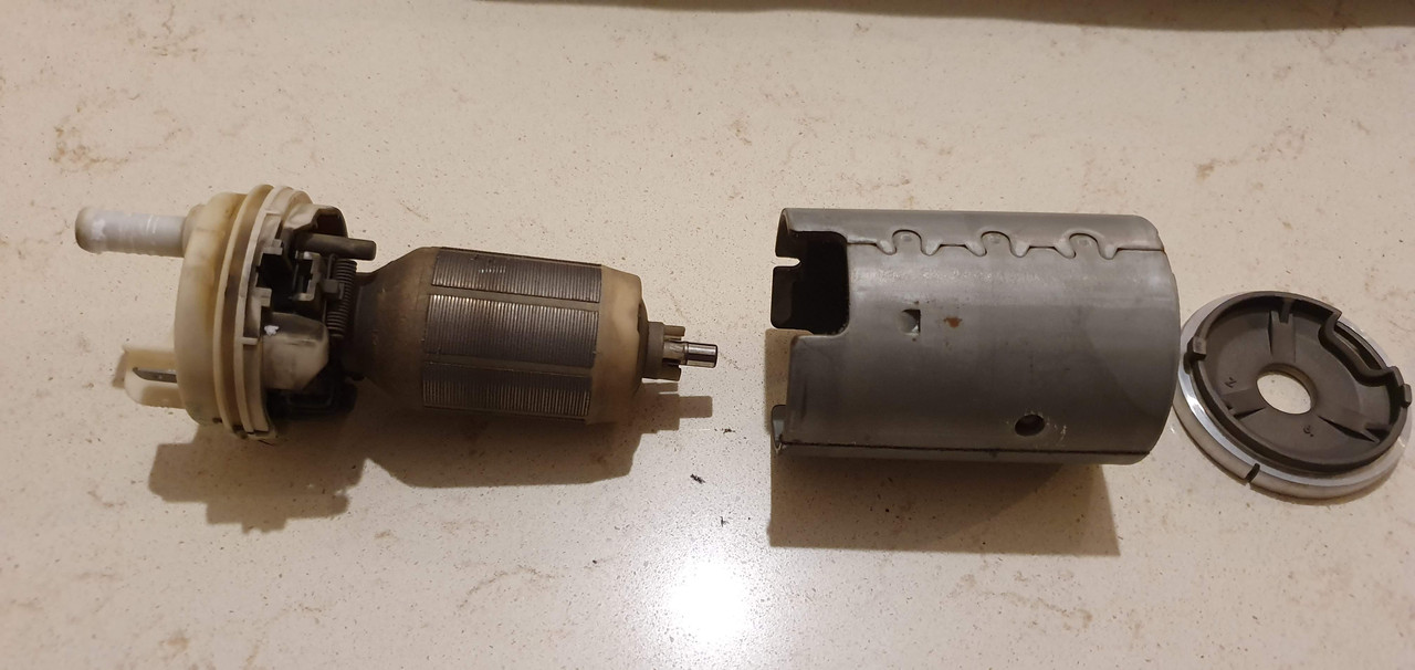

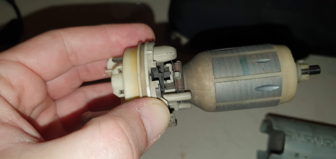

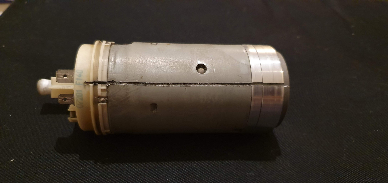

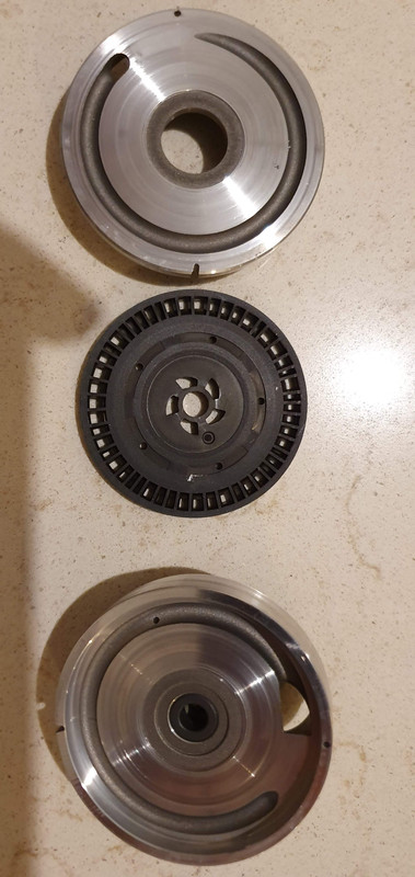

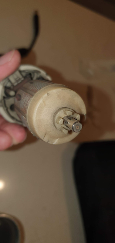

Thought I'd share some pictures of the OEM VDO/Siemens fuel pump taken apart. The brushes of this pump were near end of life and I had changed it about years ago, it was the factory pump.
I had no idea that petrol passes through the entire motor and brushes area. this means that the pump is lubricated/cooled by petrol nomatter the fuel level..
Removed the external shell with a cutting disk. rest can be taken apart by hand.

The weak link of these pumps are the brushes and commutator. Could the OP remove the brushes to show their length and the rotor's commutator condition? They could easily use brushless motor instead and it would last longer than the car.
it’s almost never the brushes. people getting over 200,000 miles and 20 years later on original pumps.
true it is a weak link, but not the weakest link.
running them low-empty overheating and poor fuel quality the biggest killers. followed by overworking them from crud-filled choked filters.
