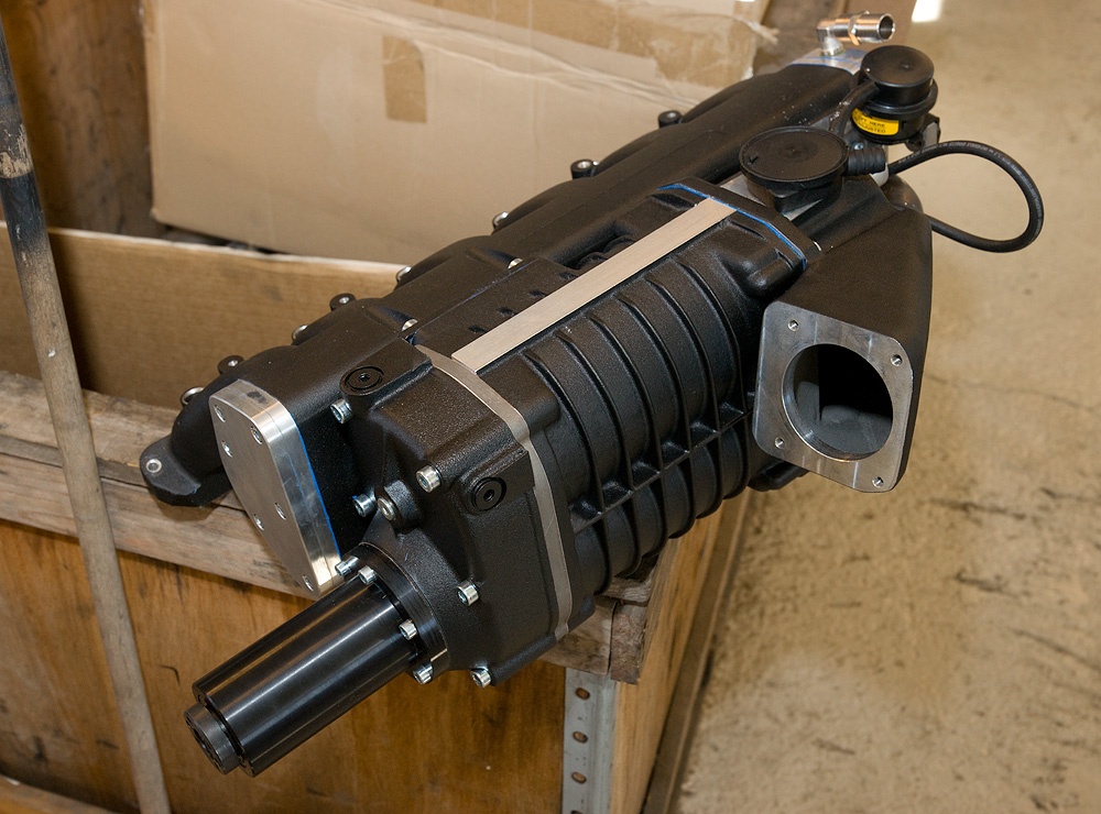

One of the downsides of having an Alpina is the non existence of off the shelf engine upgrades. Thanks to its resemblance to the M52 and M54 engines it should e possible to fit a supercharger for this type of engines with only minor physical modifications. I have been wanting the ESS twinscrew the moment I read about its existence. After several attempts to schedule a custom conversion in Norway, which failed because the shop doing all the mods on my car was taking much longer than planned, I was finally ready to deliver the car to ESS on the 6th of October.

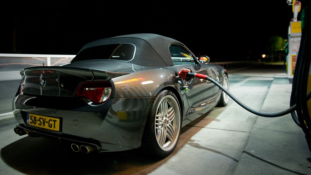

Because it was a 1250 km drive to Norway I decided it was the best way to spread the journey over two days and to leave for Puttgarden, where a ferry leaves to Denmark, on saturday evening. I washed the car, packed my stuff and left for the 500km drive at 19.00h. The weather conditions were perfect with no rain so there would be no trouble driving high speeds on the Autobahn. I had a TomTom navigation device at hand as a backup and to accurately measure real speeds. I have driven it many times on top speed before but I never measured the actual speed. The car accelerated easily to 260km/h. After several tries I managed a top speed of exactly 270km/h, which made me happy because the official top speed is 265km/h with soft top and 270km/h with hard top according to Alpina.
Ready to leave:
First pit stop:
That's me with my new toy :) :

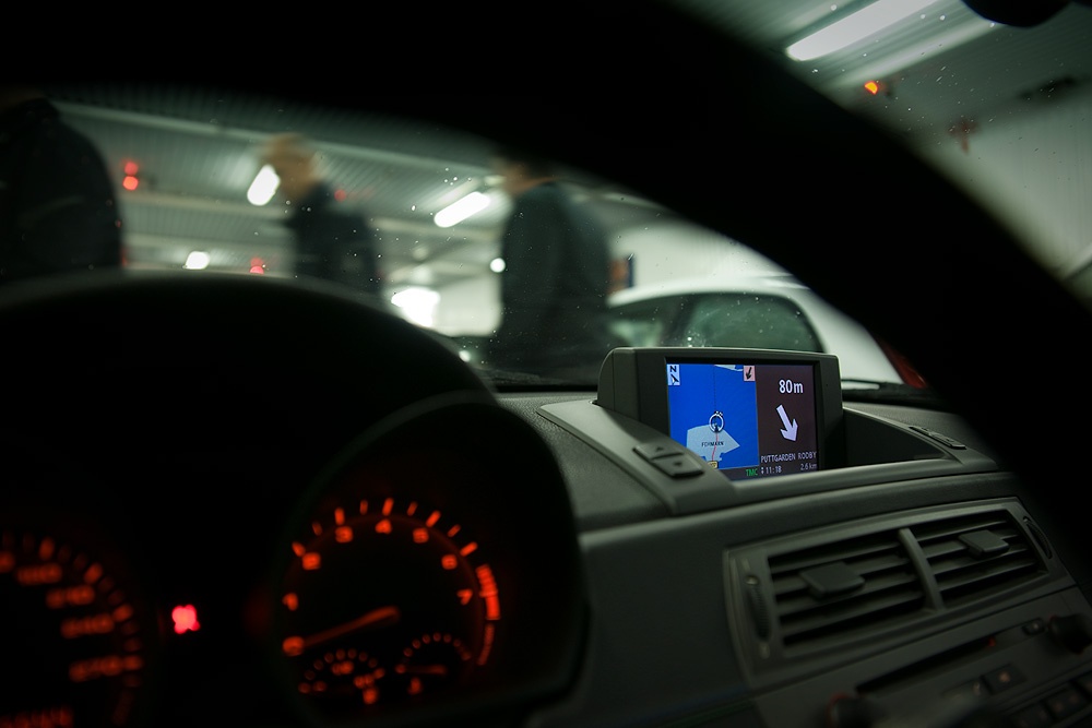

After four hours I arrived at the hotel, averaging a speed of 146km/h. Not bad since about one fifth of the route was off the Autobahn and there were also several lengthy construction works with speed limits of 60-80km/h. Obviously driving this hard was not good for fuel economy, which averaged 16,4l/100km.
The next day it was raining. I only had to wait five minutes to get on the ferry. After 45 minutes I arrived in Denmark at 12.00h and started to drive all way up to Norway through Sweden, which wasn't all that exciting because of the bad weather and low speed limits of 110-120km/h. Eventually I reached the city of Halden at 20.00h. From there on it would be about 30km to ESS the next day.

I called Hans yesterday and he had already been working on the car. There was some issue with the fuel rail but he did not expect a lot of trouble getting the other parts to fit on the Alpina engine. When everything turns out well the car should be ready in two weeks.

The hardware is done and Asbjorn is working on fine tuning the software. It develops around 370HP at the wheels @ 7 PSI boost up from 270RWHP. That equals to ~435HP at the crank with a 15 percent correction factor for drivetrain losses :str8pimpi .
