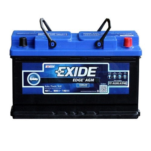

#18 ·
I got this a few days ago:
Question for the pros...when I get my new battery, is it recommended I put it on this charger and make sure she's fully up to charge before installing?
Sent from my ONEPLUS A6000 using Tapatalk
