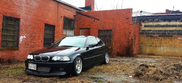

These rims were originally on my x5 so I'm guessing the center hole will not be the same as my 3 series. Im going to put the factory x5 rims back on and use the tires that are on my black rims on the factories since they are both 18s and the same. Pretty much just trying to save money by reusing rims instead of getting new ones for my 330 for summer and new tires.

I think all BMW models except the e39 5 series have the same 72.56mm hub size. Even if the hub size isn't the same, it will be larger so you could just buy a hub centric ring and it will be fine.

Depends on the year X5 I think 2007+ have a 74.1 centerbore so you may need hubcentric rings to avoid any excess vibration.
